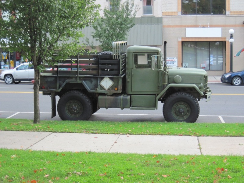

Plenty of time spent with Rockwells, just not under civilian vehicles.
I can tell you that my 4x4 gps' out at 74 mph with 47" Goodyears on paved road.
I have room for 1600's which are 53 inch but, it kills the power on grades while holds speed good with the smaller tires.
For serious off roading definitely need lockers in rear and front if you also install lockout hubs for 2 wheeling down the road.
AFTERALL, HOW HIGH DO YOU NEED TO GO, EH!
