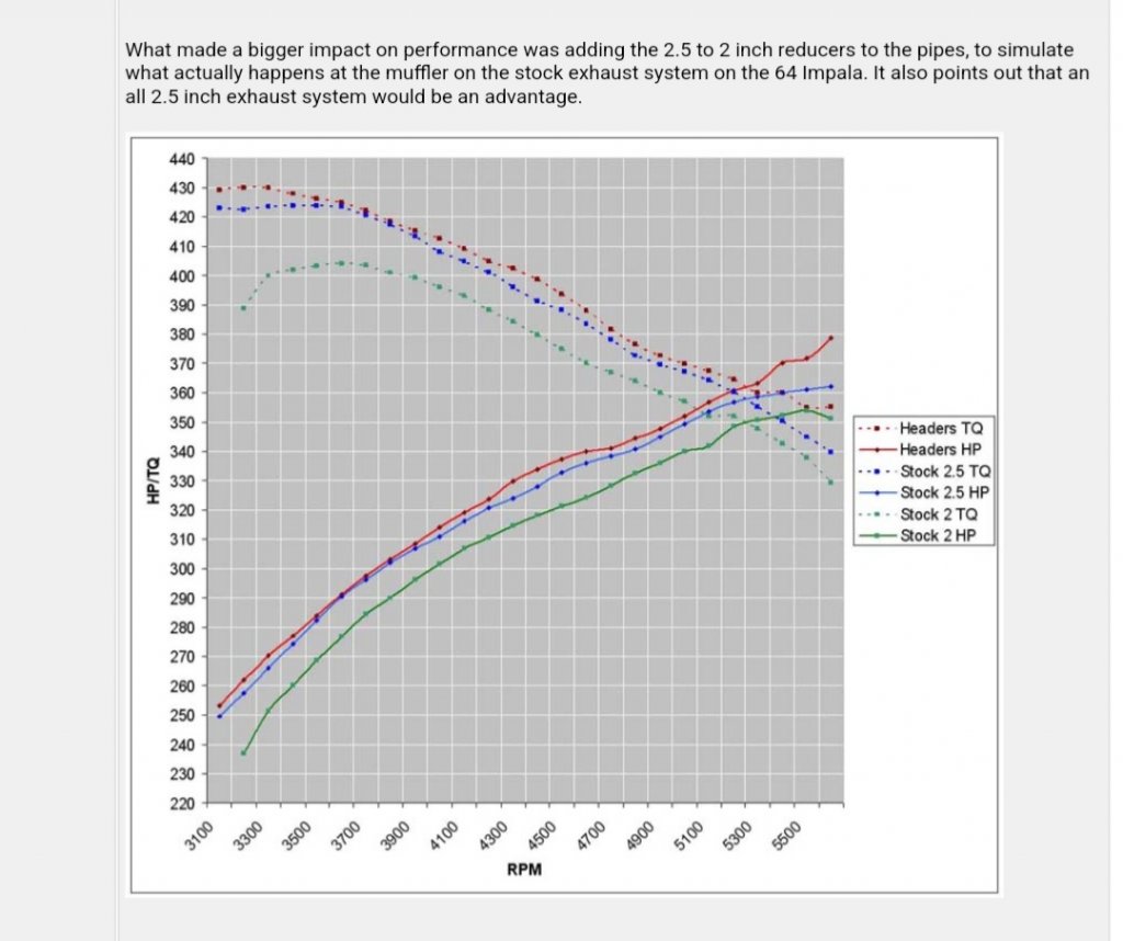

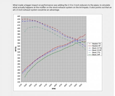

Dyno sheet 2.5 rams horns,2 inch rams horns,headers on a 383. Before all the rush to buy 2.5 inch rams horns,they won't fit our trucks,the 2 inch angled ones will,but aren't very good.If I wanted manifolds, I'd look at some lt1s . Look at the difference the headers make at low rpm
