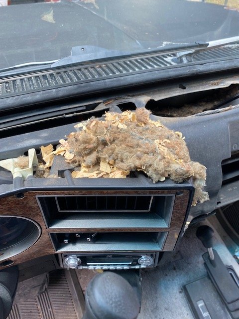

I really appreciate all the insight, you guys are definitely way more knowledgeable than me and maybe more than my mechanic. Long story short, it still isn't right and yesterday I lost power going 30mph down a side road. It smelled like burning metal, but once I let it sit for 5-10 minutes it started right back up and I drove it to the mechanics. I'm still getting the same code. Basically from 0-35 the truck runs rough. I'm thinking it is multiple issues, maybe transmission because around 35mph, it shifts in and and out and loses power, maybe torque converter? It sometimes needs me to pump gas for it to start and stumbles from 0-10mph. We redid the grounds and ignition module along with the distributor. I've attached a pic of what I found under the dash, the mice were living lavish. Is there anything these mice could have done to cause this?
Going crazy, ready for this to be mechanically sound to be redone and painted. Could it be the TBI? Anything that I could throw parts at?

mice could have chewed wires under the dash....I'd check things over thoroughly while you have the dash pad out.

That's to bad the mice got in there. I would be definitely checking the harness. Especially by the ecm theres a pretty good spot for them buggers to make a nice home up there.
