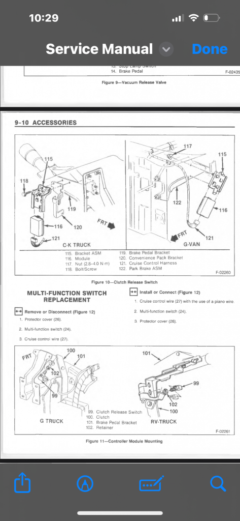

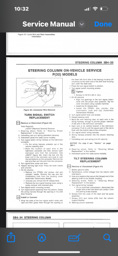

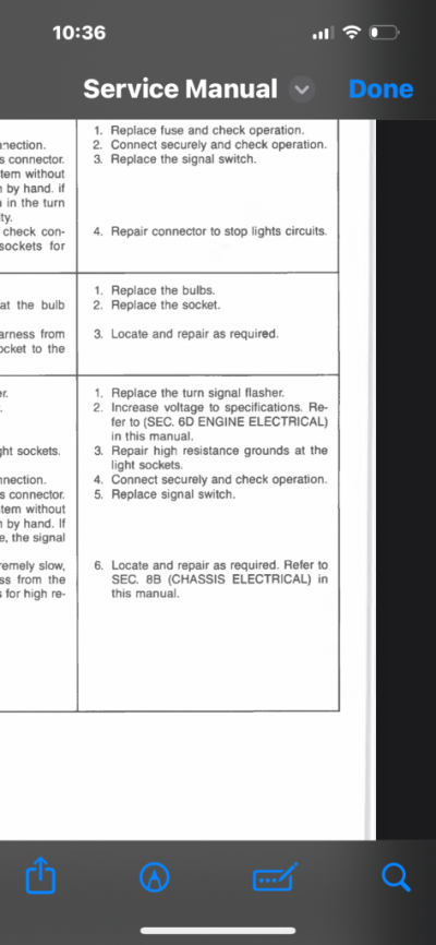

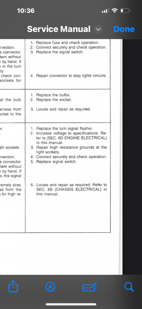

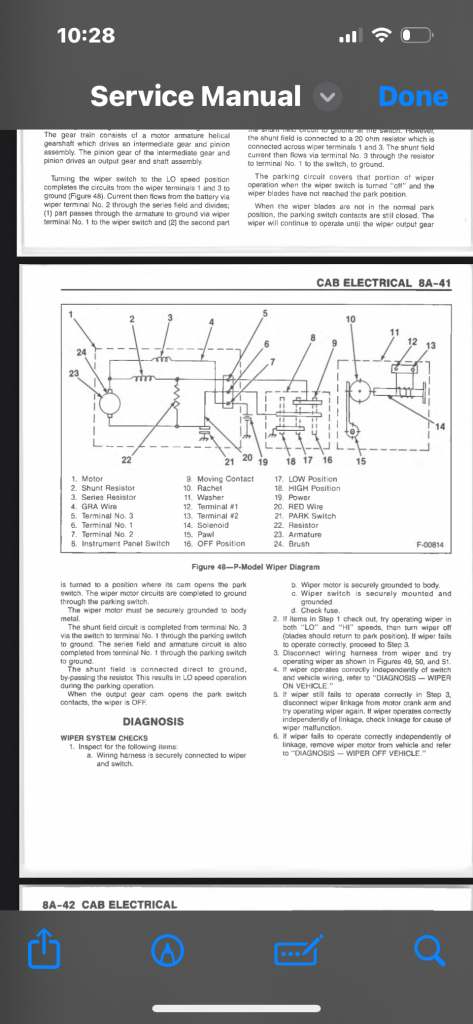

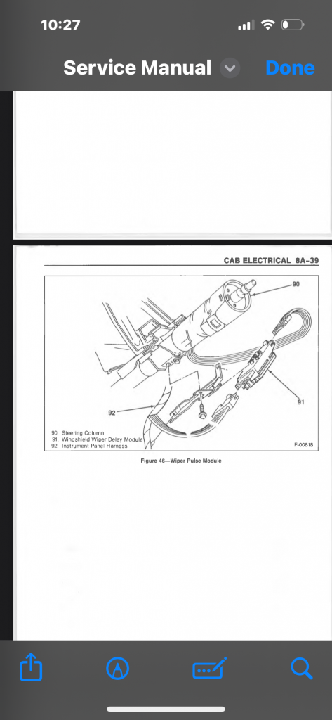

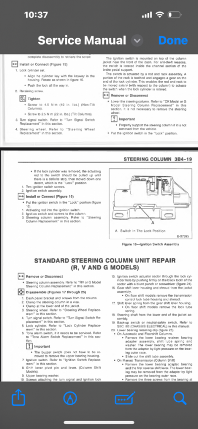

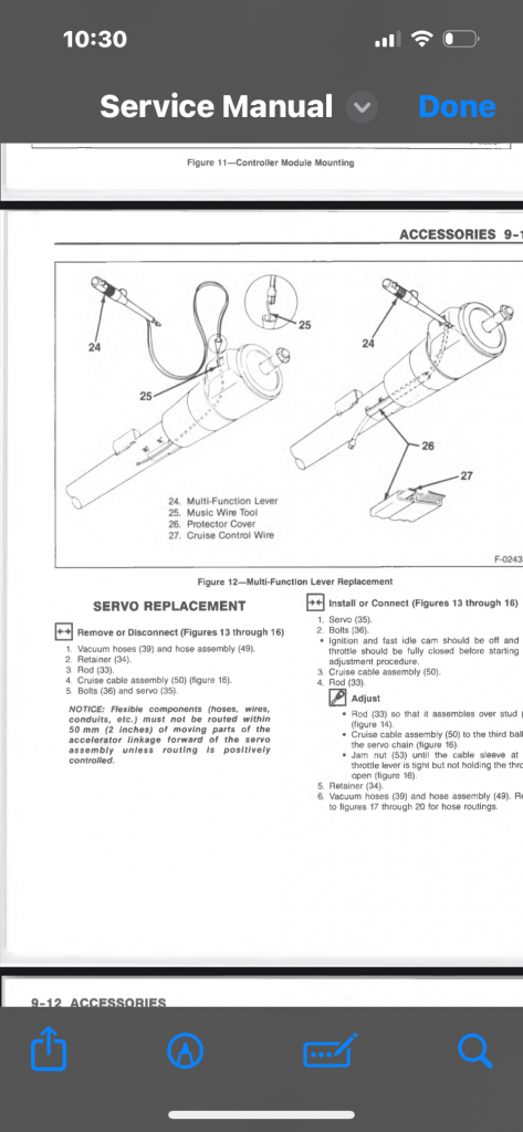

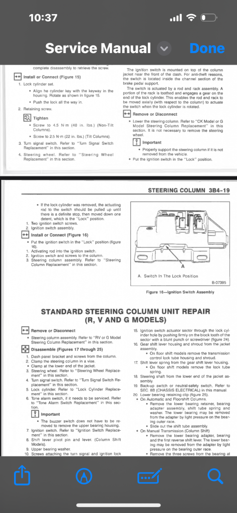

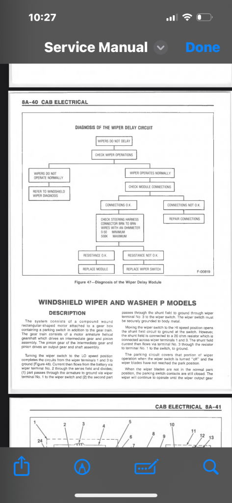

This manual is available on the forum to assist in full depth, this is just what I quickly pulled off the copy I have at hand

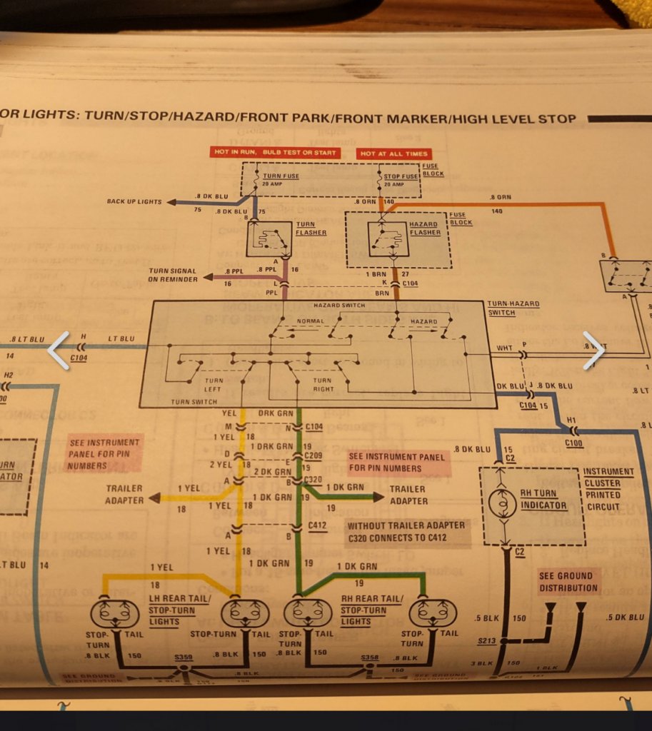

Here is a wiring diagram from a 87 G body, should be very close to what you need.
