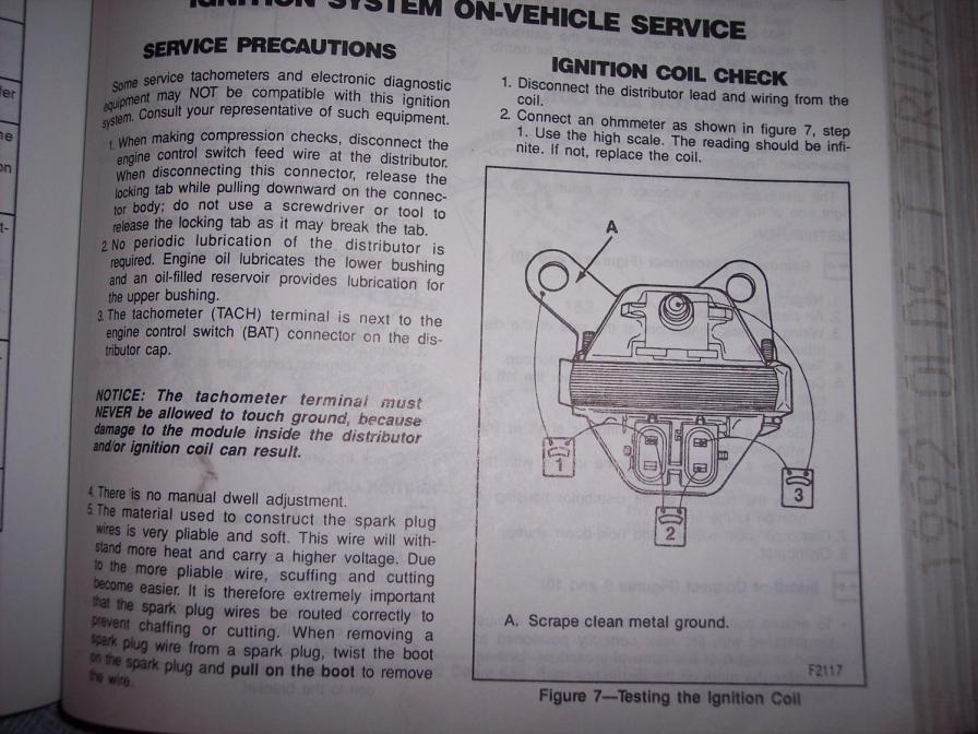

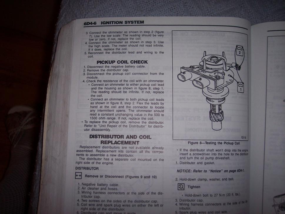

i just purchaced this for my wife the guy before me had a care ignition module on it and a crane coil i removed the module and left the coil should i test that with a ohm meter
RetroC10Sport
Sep 29, 2010
17,101
2,237
Green Bastard Parts Unknown
Jay
2001
pontiac aztek
3.4
From the service manual... :)

Thank you I will try that this weekend

of course testing the pick up is the smart thing to do, will tell you this though that is usually what will be wrong, is the inside of your dist full of brown rusty gunk or a lot of play in the dist shaft? check for play as they are known to go bad also
