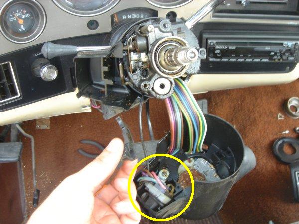

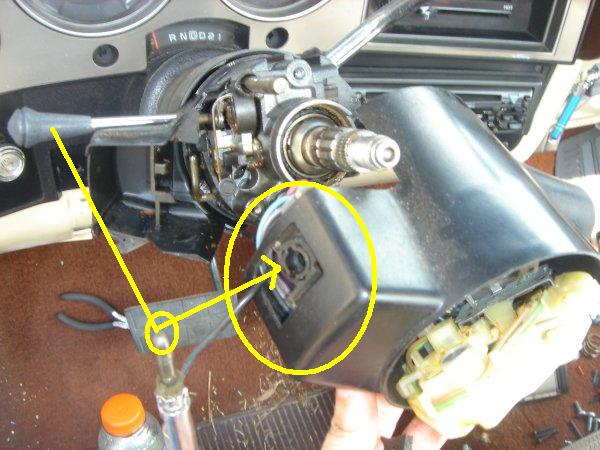

Hard to believe but yes. Pull straight out away from the column towards the door. Not towards the steering wheel!
47,132
9,331
Both of my running and driving squares have slow working wipers. I just figured it was tired motors and figured I'd replace them someday. Guess I'll use the troubleshooting chart first before I spend the cash when the time comes.

. The wire on it feeds through the column and is a real bitch to feed through it. When I put my new one in I just ran the wire outside the column and phuckit.
That is exactly how my wire is. Works fine. I don't care how it looks, it was too much trouble to fish it thru.

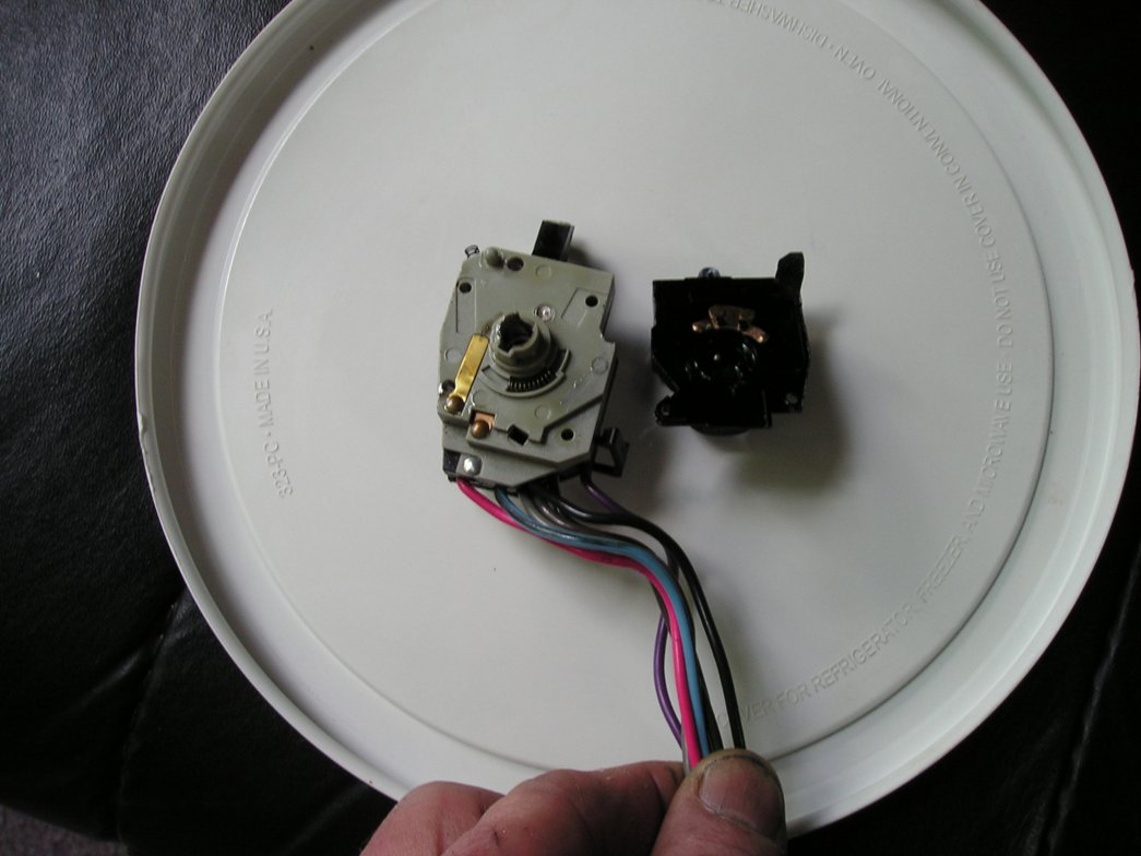

Here is the wiper switch/dimmer control removed from a column I did a couple of years ago - PITA:

So you just PULL on the turn signal switch???
Just to be sure, you do realize that he is only talking about the handle for the wiper switch and not the actual switch. The wire he mentions is just the cruise control cable.
To change the wiper switch is fairly involved - google it.
Here is a good tutorial about steering column service:
http://www.truckforum.org/forums/gmc-truck-forum/35364-77-gmc-steering-column-help.html
Yucky. Did we have to link to there? :rofl: Although, since it's ChevyChase's thread, we'll leave it. :waytogo:

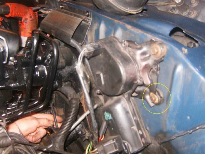

I really wish you had a spare pulse module to try. So many problems are caused by that component. I swear, it should be the first check on any wiper motor problem diagnostic chart. At least unplug and re-plug it (both sides) to try to get a better connection. Then go to the junkyard and pull a couple to test with.
In the mean time, and this probably won't help, make sure that there is no paint on the wiper motor housing under the shoulder of the mounting bolt as indicated. Try cleaning the paint off all 3 bolt points:
