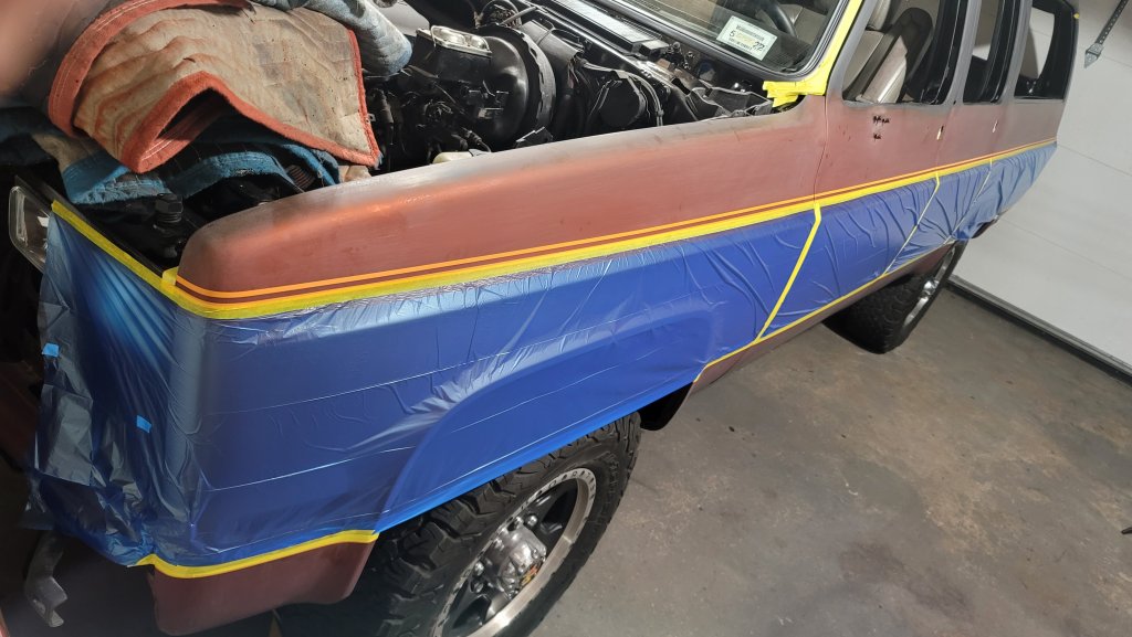

Here's my '87 straight from 1989. In post #2, are those dually stripes? See photo #4. They go over the rear fenders.

Yes they are. There are also long straight stripes in the kit for srw trucks.
The kit has stripes for all models.

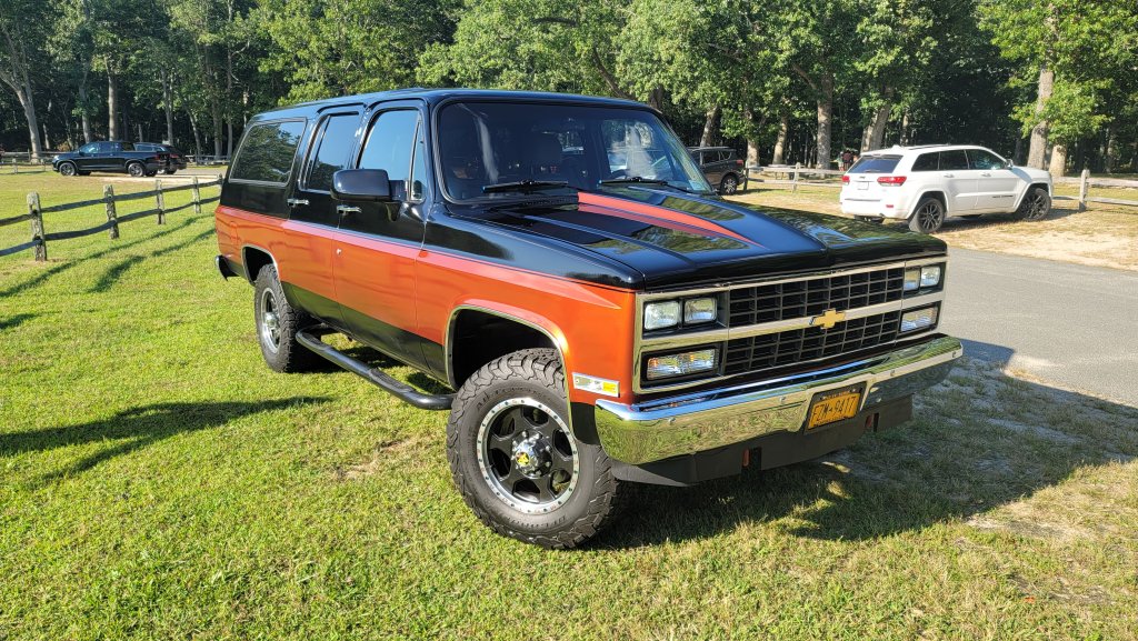

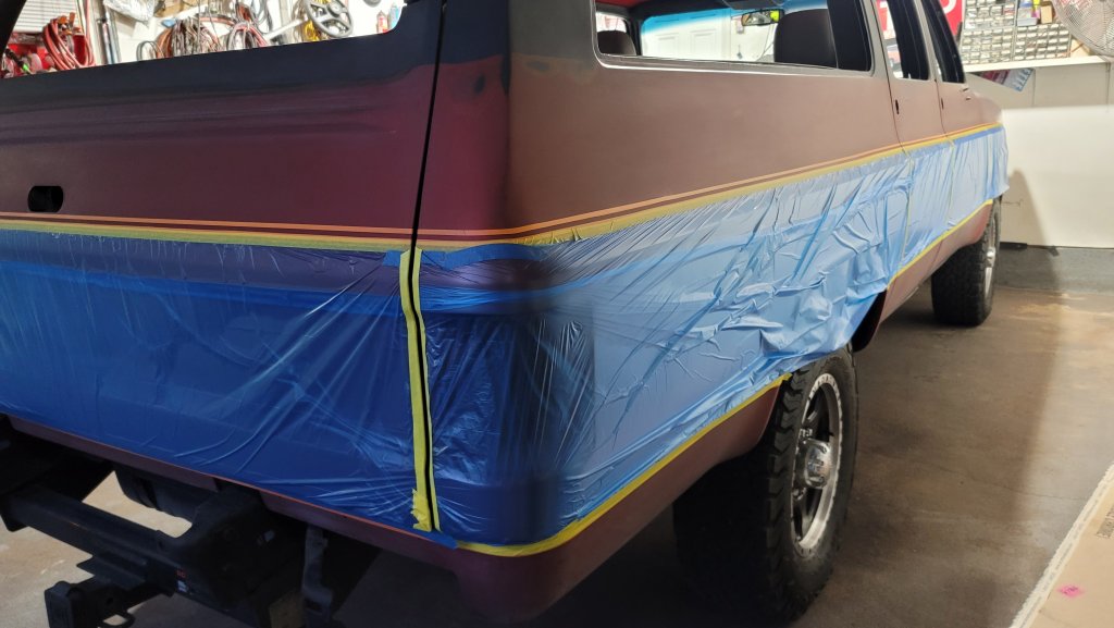

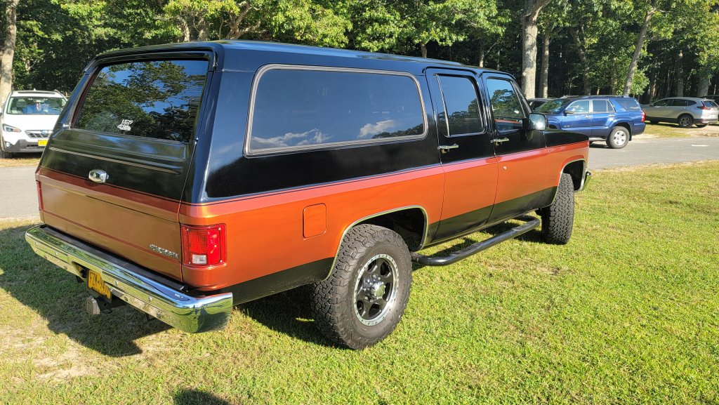

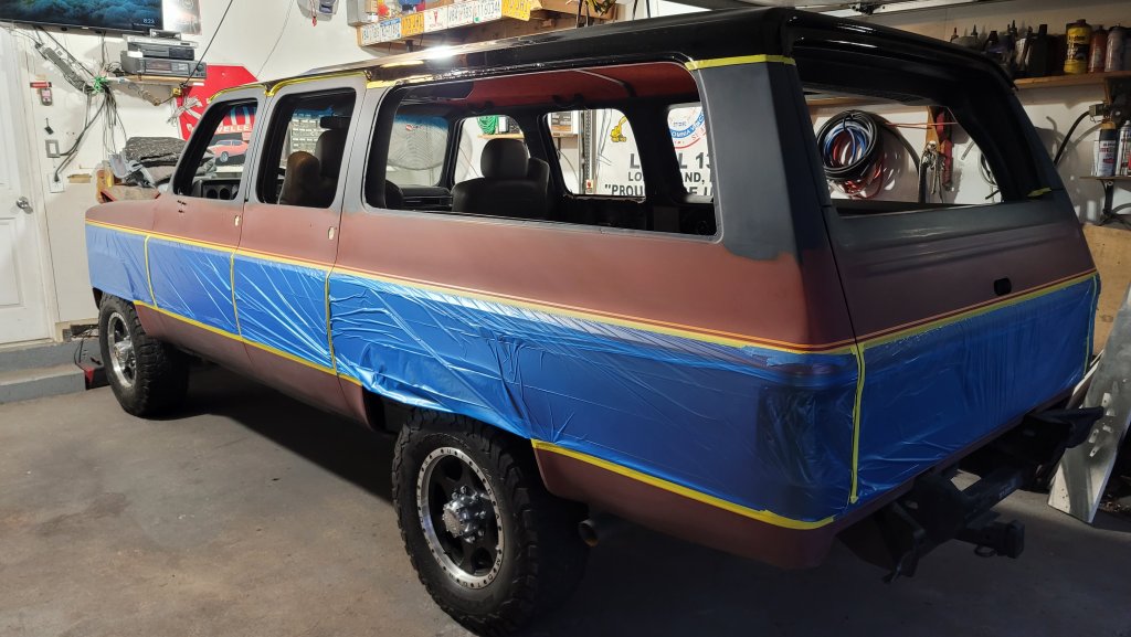

if it helps,this is where i put my lines.

i used a lazer beams lol

I’ve painted a hundred of these trucks and the best I’ve found is to mock up your decals after the first colour is on and divide the difference to get the 2 tone line in the middle of your stripe. If you clear over both colours at the same time there will be no god awful edge in the middle of the stripe and give you some wiggle room. I always lay out all the stripes till it looks right. The factory throws them on over a vicious 2 tone line and that shows through, yuk. It’s most important to have a nice look down the side and it’s easier to start with the look at the grille and marker light. When the decal is relaxed in place that is your bench mark for the side.

Appreciate the advice! I got most of the 2 tone line sanded out. The bed is butter since I re-cleared the dark stripe with the top color. Cab just needs a touch more work then I can put the stripe anywhere it covers.

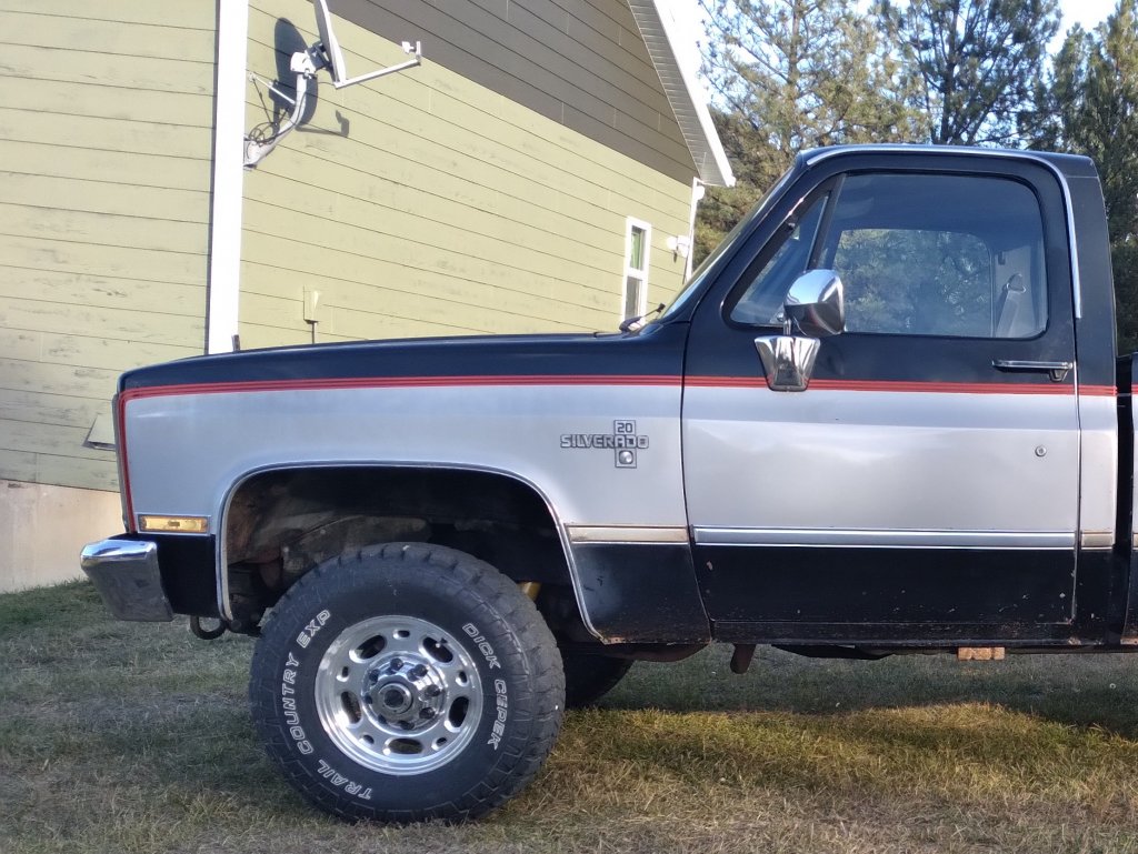

Looks great, Grit! I'm a bit of a purist, so as close to stock as possibly imho....WHATEVER that might be! Haha. Although my paint is a bit haggard, it retains the factory scheme for 1987 anyway.

Thanks grit,i went my own way i little.
