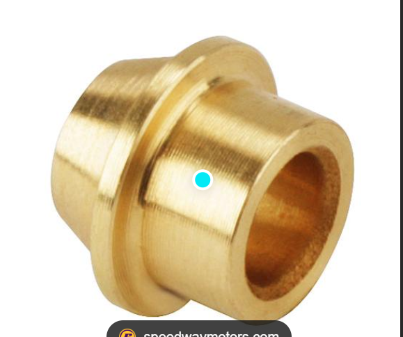

Thanks, I saw the adapters that would convert the oring seal to flare (see attached image).
I also tried removing that flare thing with some needle nose pliers from the steering box thinking someone had added that adapter in there and the steering box was actualy a 1984 oring style, but no. The flare didn't come out.
I would need the opposite, an adapter that would change the male flare on the steering/gear box to receive the oring hose end.
Does anyone know if these adapters exist? flare to oring? SAE to metric?

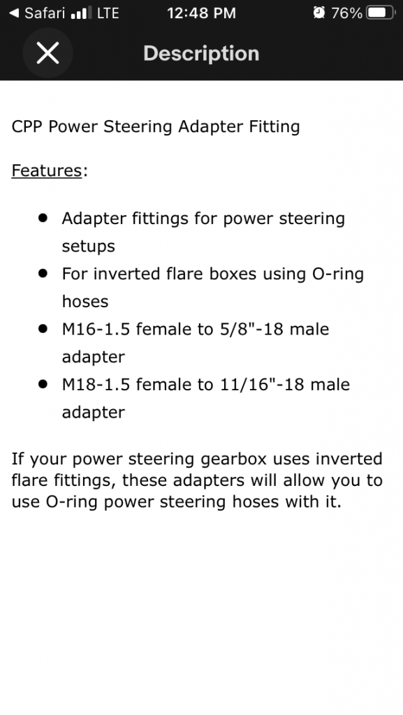

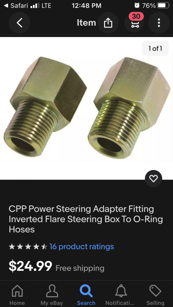

I just found these on eBay. Seems they could be the correct thread sizes, need to confirm that later today with my caliper and thread gauges.

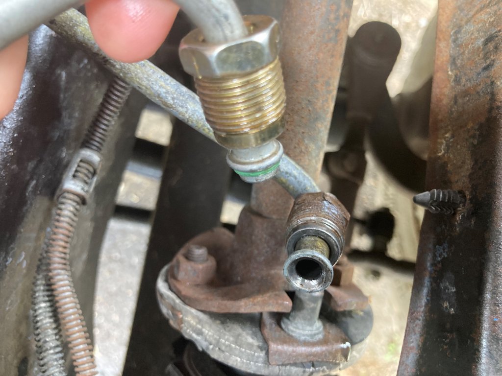

This is what Im trying to adapt, Old=Flare New=Oring
Those should do the trick.
