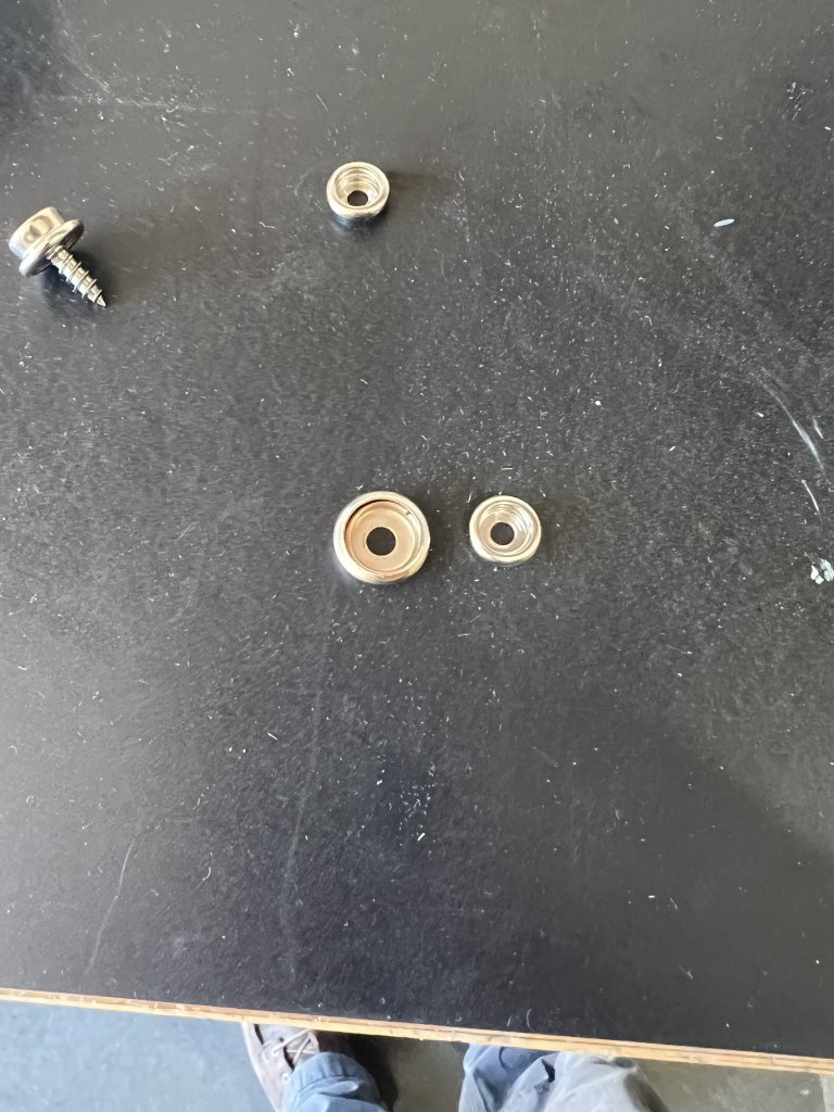

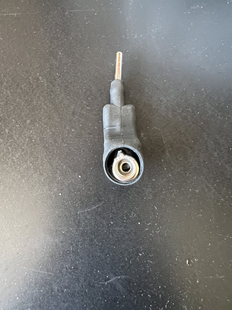

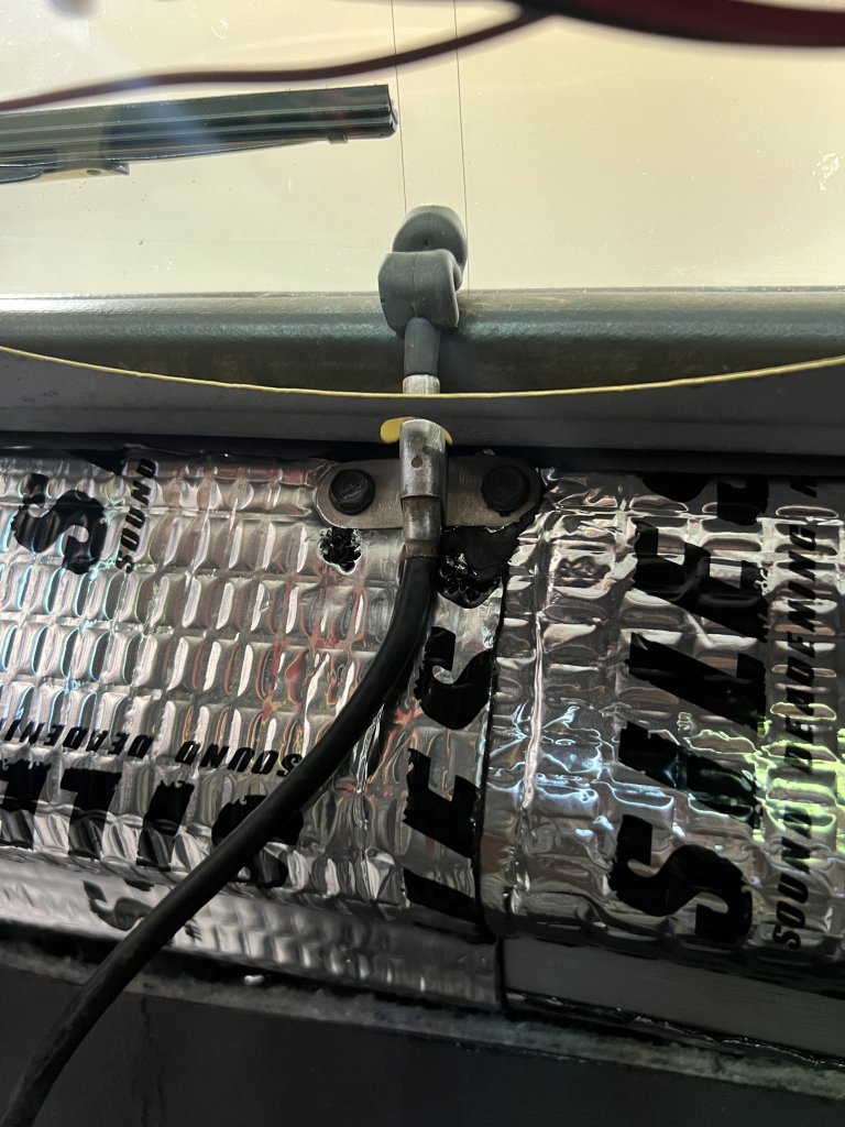

Came up with my own solution. Windshield button is a 1/4" button. Cannibalize the cable lead into the windshield adapter. Removed the button that was on the adapter and replaced it with a 1/4" button I found at OSH.
