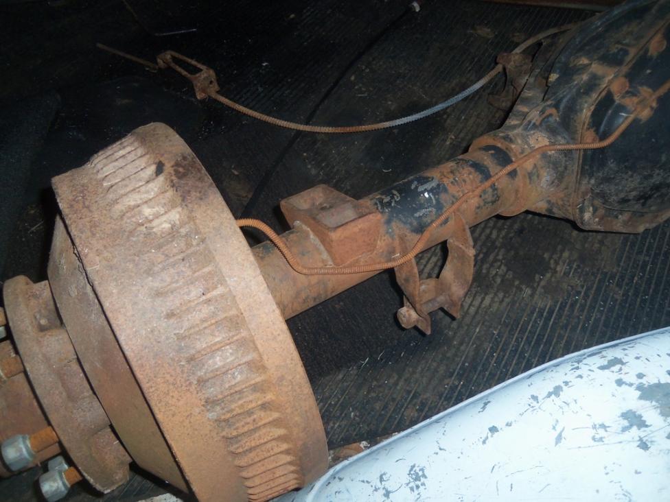

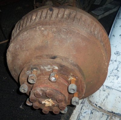

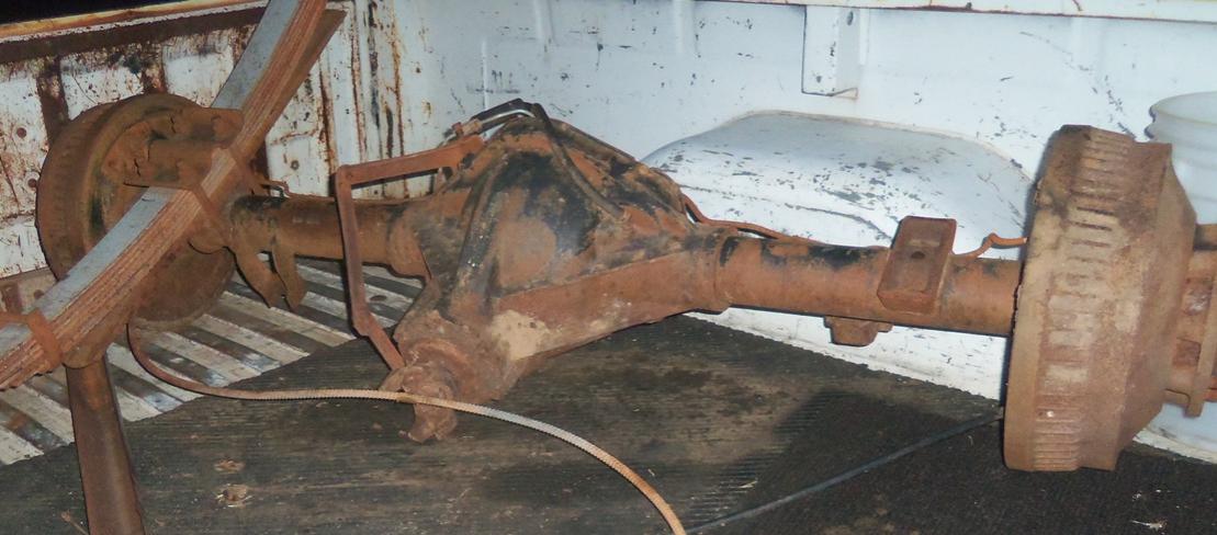

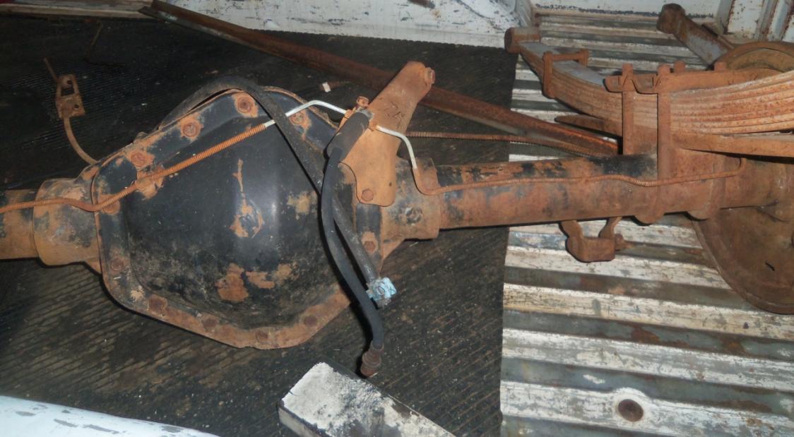

And so it's in the thread, here's the 4.10 14b FF I picked up last night for $100. Haven't even unloaded it yet out of the back of the K1500.
Axle Tube Code is GMD According to the Library, it's a 85-86 C20 Non Locking Diff. :waytogo:
