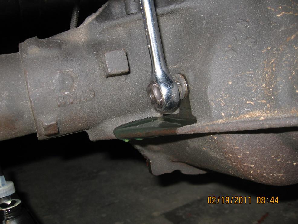

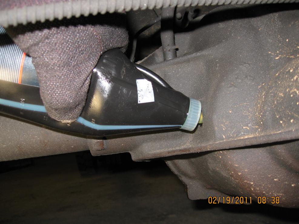

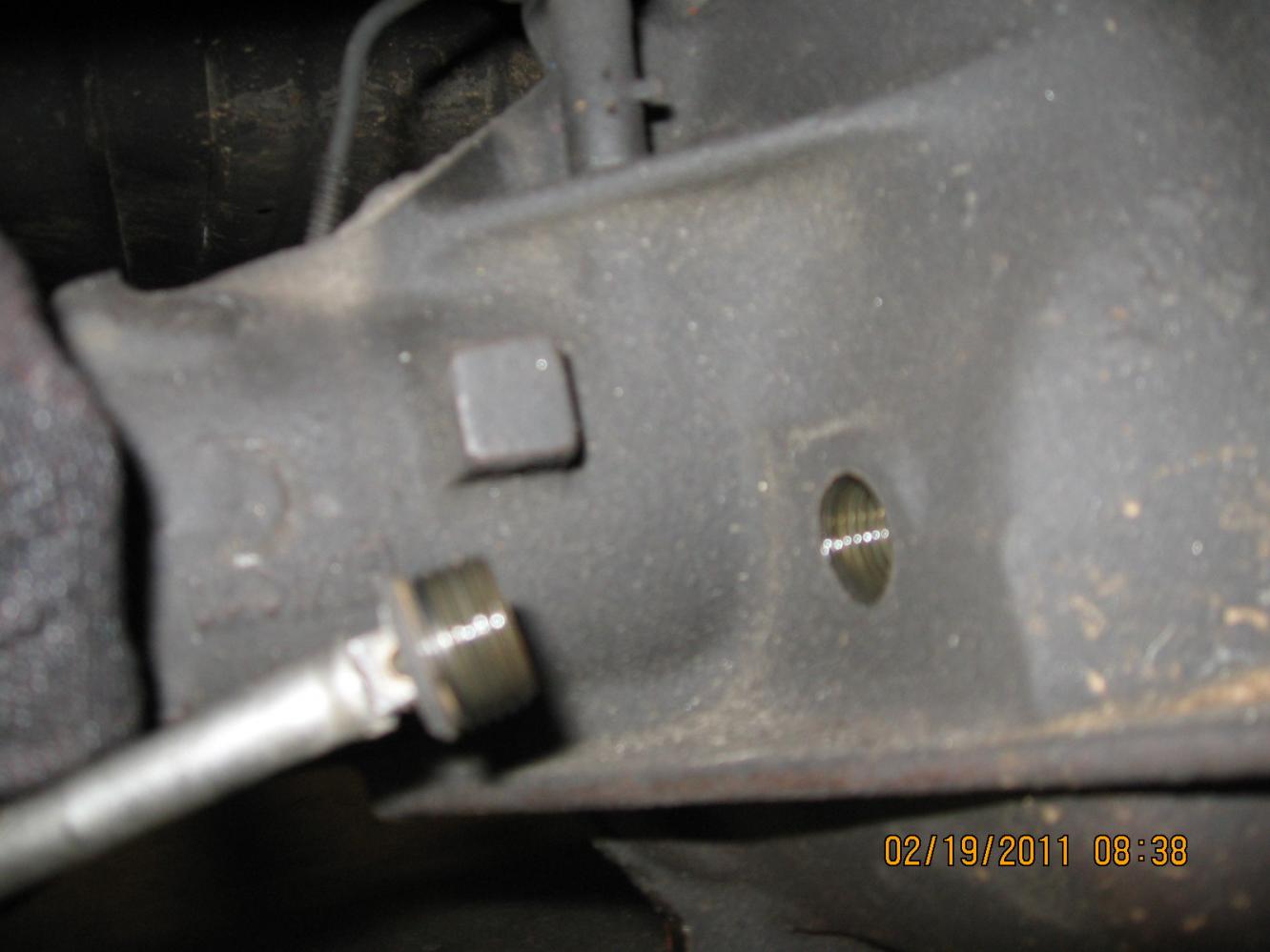

Fill til it comes out of the bottom of the hole and replace and tighten plug.

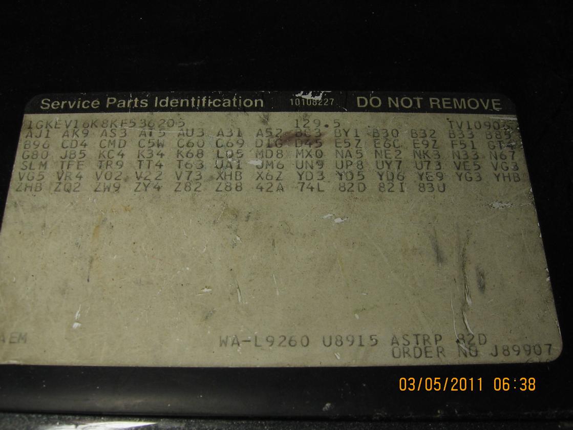

I don;t know how to tell buddy. Where do I look? In the glove box? I'll have to take the drywall screw out to open it, lol.
47,132
9,329
Well hell yes. You'll have to take the screw out and take a good pic of your RPO code label and post it up so we can see your RPO codes. I am very interested in seeing what code they gave for the LSD. Maybe my truck have it too and I just don't know it.

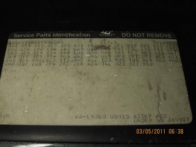

What can you make of this bud? :popcorn:
47,132
9,329
I can make you got a G80 locking Diff and GT4 is 3.73 I do beleive. When I get a bit more time, I'll look over your codes, But G80 is usally Gov Lock junk, so someone may have swapped out your carrier before. Unless there is somethign I don't know which is very very possible too.

So the code is for govlok, but you think the pic shows something different? This has been taken apart before.... :think:

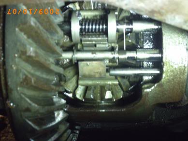

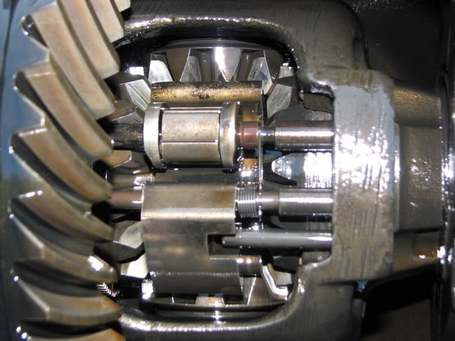

I'll look again but for some reason, on your change gear oil thread, that didn't look like a Gov-Lock set up to me. It looked more like a Limited Slip set up to me. If I am right, and I could be wrong, if I a right, either someone swapped out the carriers to a LSD unit at one time, or GM used more than just Gov-Lock for locking differentials.
I am thinking gov lock has like a Cam wedge system, not springs for 1. Also I do not see the gov gear outside the ring gear that is notorious for stripping teeth and why the govlock sucks.

Yah, ok, I wasn't sure what ya meant bro. So what I do have is not factory then, right?

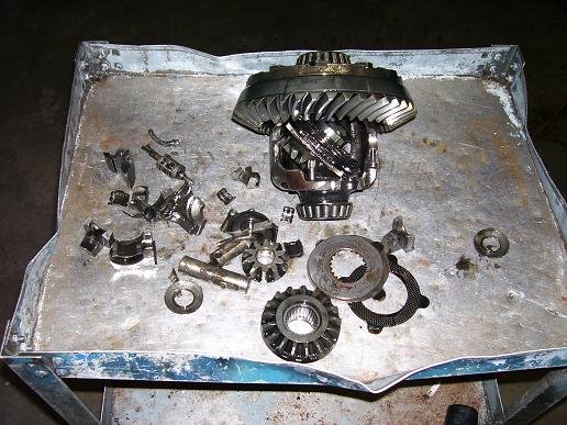

Here are some Gov-Lock Photos
Eaton Gov-Lok 12bolt
attachment.php
Eaton Gov-Lok 14bolt Semi Float
attachment.php
Eatup Gov Bomb Unknown Axle Aka GovBomb, aka GovGrenade and why many don't like them.
attachment.php
