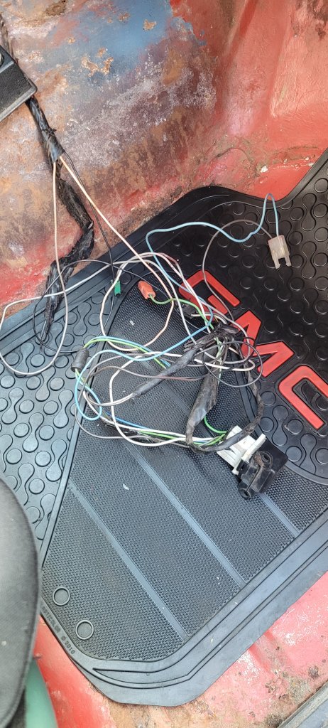

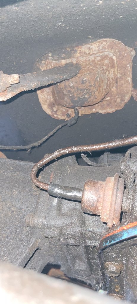

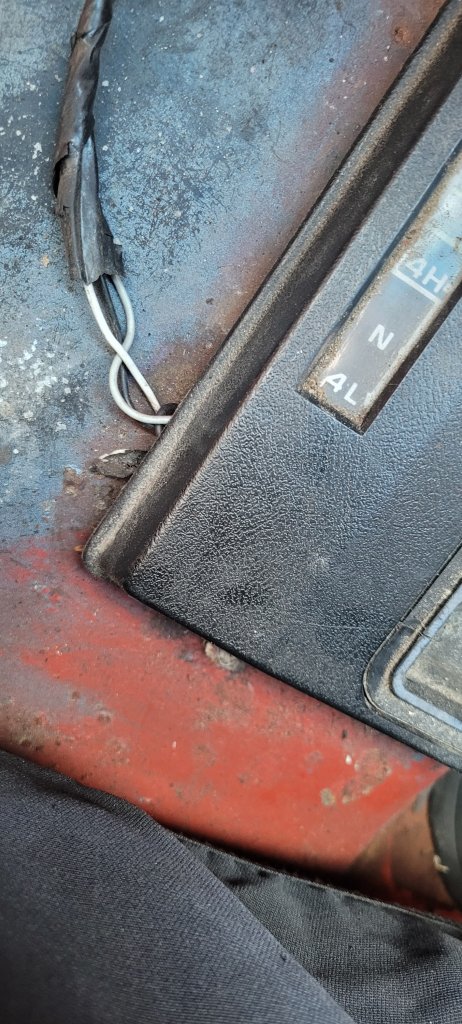

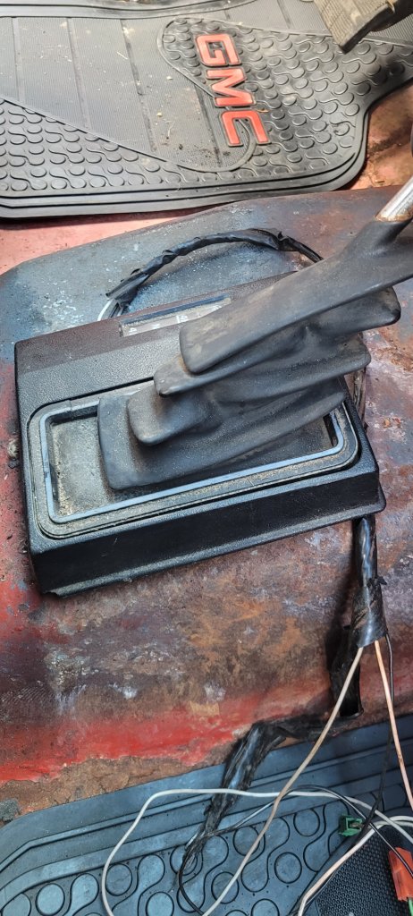

I'm currently working on my 1981 c10 chevy, and I've found wires coming from my 4wd transfercase. I have no idea where they're from or where do they go or if they're even stock at all. Anyone has had something similar? Images related.

Should be a light to illuminate the shifter indicator and also a switch there to provide ground to turn on the 4wd light in the dash.

first picture is the floor shift for a TC, truck probably misidentified.
