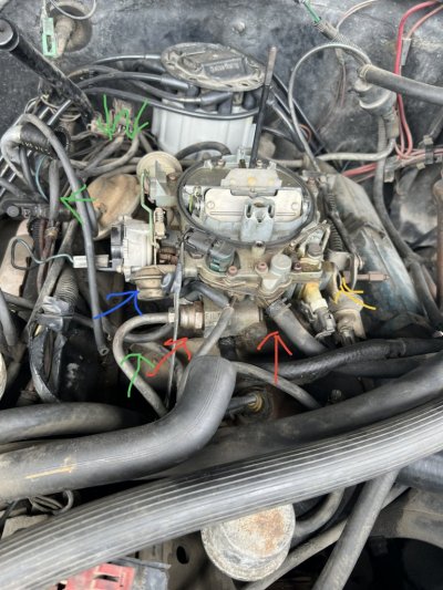

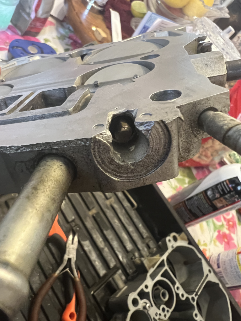

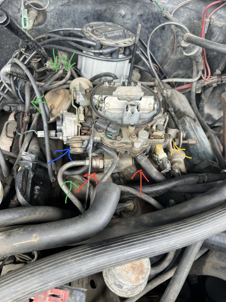

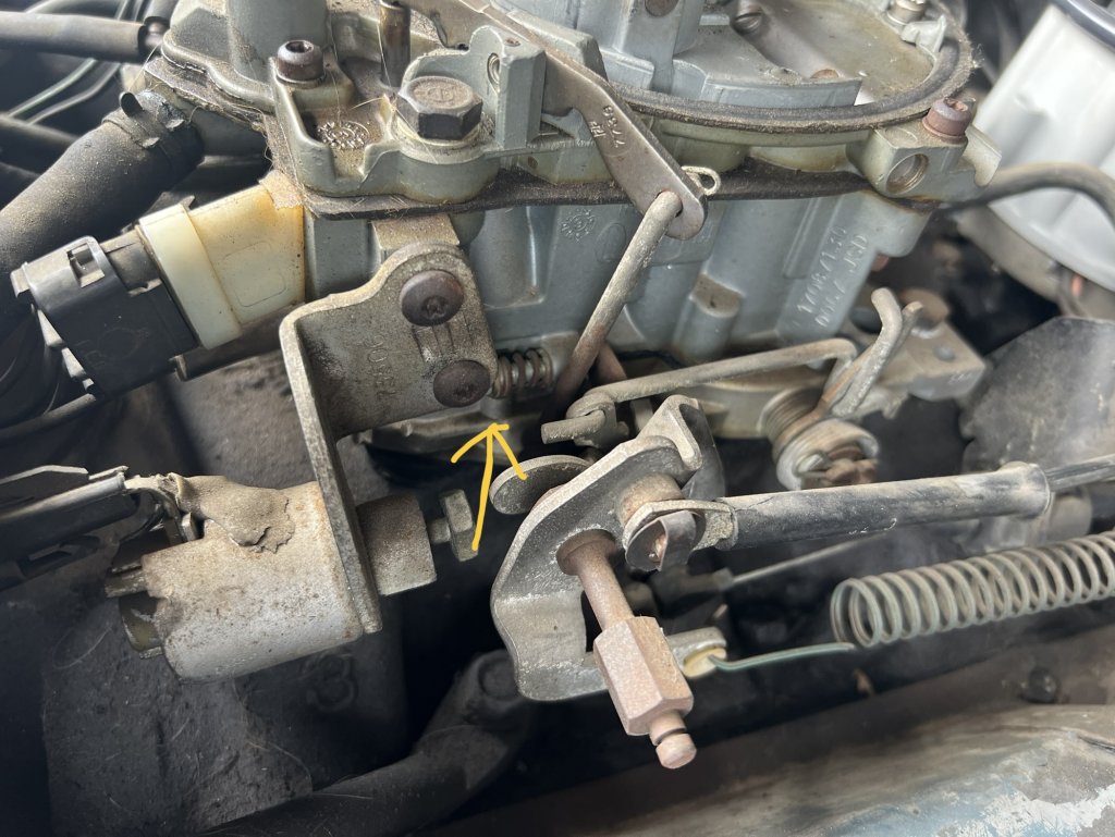

Ok so coming back to this thread again because I moved forward but still not exactly where I need to be. Thank you all for the replies I didn't check it out too much because I am impatient and went to go see if I knew anyone who had experience with this engine and carb to give me some advice as well.
So a little more information it is a 305 4bbl with an em4e (ill include a picture of what it looks like) quadrajet.
Here's what I've done in the past month since I started this thread.
- I moved away from the fuel pump just because I know when I got it running for the little bit it did run that it seemed fine at idle and mostly while driving. Plus from what I've heard and read its also not as common for the mechanical fuel pump to go bad on these. I may be wrong there
- I rebuilt the carburetor which took me forever and was a fun albeit tedious experience and if you go this route and don't already rebuild carbs take way more pictures from way more angles than you'll ever think you need because if you don't youll have fun guessing where everything goes back and how it goes back.
- I found and fixed a vacuum leak in some small vacuum lines. I've been looking for a diagram that tells me which lines are which I found one on day two of the carb rebuild online and made the mistake of not saving it and couldnt find it again.
Here's how it went:
After reinstalling the carb the engine had a very high idle that was around the 1100-1600rpm range that I could not figure out for the life of me. The tuning video I watched just used the idle screws not the mixture screws so I had no clue about the mixture screws and that you have to tune them with a vacuum gauge. Figured out that I needed to do that so after using the vacuum gauge and mixture screws to tune the carb my idle was still high 1000-1300 range but the vacuum was steady 16-18inhg (side issue that I didn't attempt to fix that just went away was that the idle would eventually drop from the 1000 rpm to <500rpm till it stalled). So I was inclined to believe I had a small vacuum leak. Took a hose and some butane went searching for the hole in the small vacuum lines. Once found and the vac lines were replaced I was able to retry tuning again.
Now here's where I am at currently, I went to retune the carb the mixture screws didn't need much adjustment which surprised me since I would assume the engine would be running very rich without the extra air coming through the vacuum leak. My idle is still high at 950+ rpm and there was only a very slight difference between the high (cold idle) and normal (warmed up idle). I was able to back off the normal idle screw all the way and could not get the engine to idle lower than 850rpms once warmed up. The vacuum is steady 18-20inhg and the engine starts and idles beautifully besides it being a little high and no longer drops 100+rpm after it is revved. I have gone back over it with a hose and the butane can again and could not identify any leaks
My question now is does anyone have an idea of what could be the current issue? Possibly another small vacuum leak or maybe I just haven't tuned the mixture screws properly? Could the pcv be bad and cause this? I will continue doing research but it would be great to hear your opinions.
Oh and if anyone has any tips for tuning the mixture screws cause on mine they have no screw head just flatend on 2 sides that look like it can be gripped with pliers (ive been using very small angled needle nose pliers) but the area where they are located on the carb is the most inconvenient spots.
Here are the pictures they are from before the rebuild just to show the components im referring to. If having better or new pictures would be more helpful let me know and I can take more.
The red arrows are the mixture screws (also shown in the last picture), the blue is the high idle screw, the orange is the low idle screw (if i named them wrong please let me know), and the green arrows are the vacuum lines i replaced due to leak.
If there's any questions I can answer or pictures I can provide to give a better understanding, please feel free to ask. Thanks
