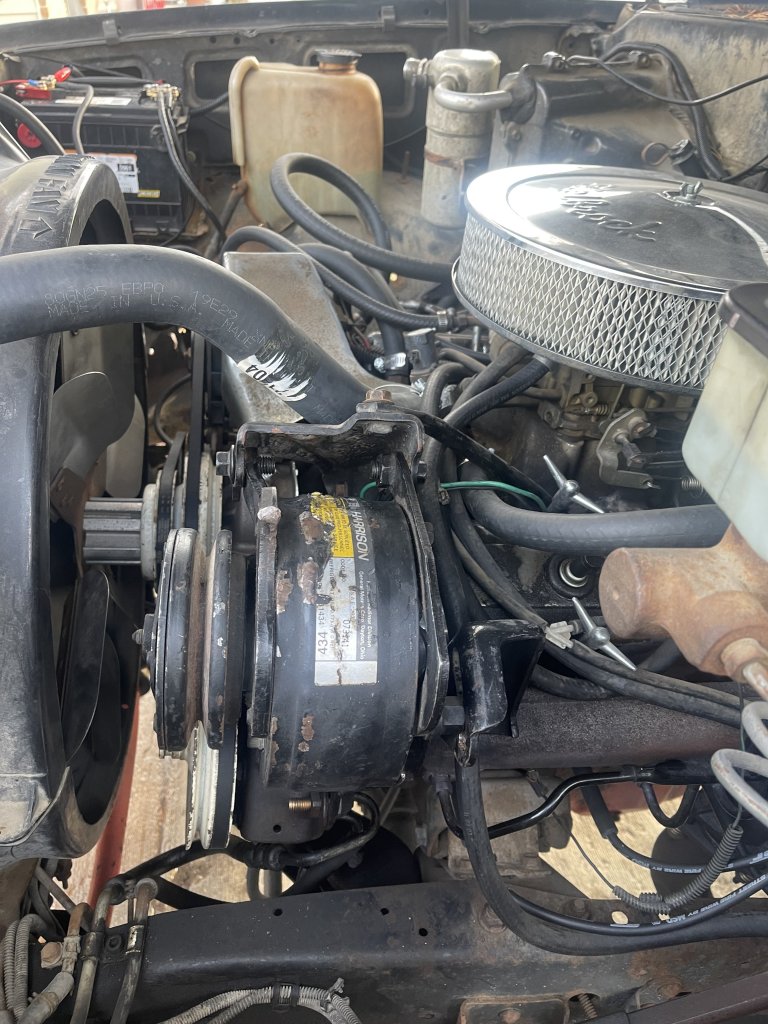

The A/C Compressor I have is the pancakes style I believe. Here's a picture of the the one that came with the truck. I have it had mocked in place to make sure I ordered the right one.

That's an R-4 compressor - no reservoir... Unless you're going for the "stock look", that's the last choice in compressors.. An A/C system doesn't know which compressor is installed in the system.. All A/C compressors work the same way, they all pump freon while it's in a gaseous state... The big A-6 compressor doesn't lend itself very well to cycling off and on. A Sanden or similar would be a better choice. Vintage Air and other automotive A/C manufacturers offer a line of replacement compressors along with proper mounting hardware.
