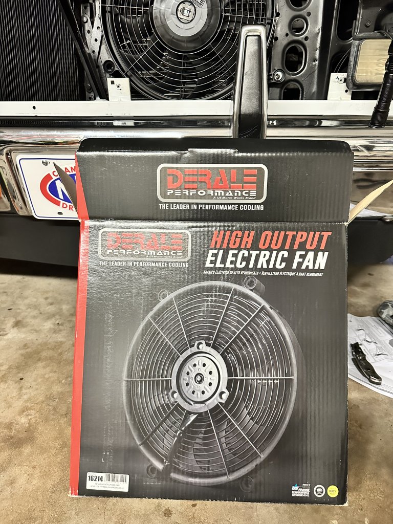

I’m in the process of installing an auxiliary 14” Derale electric fan in front of the condenser. I’ll post results when I get it back together, hopefully by this weekend.
