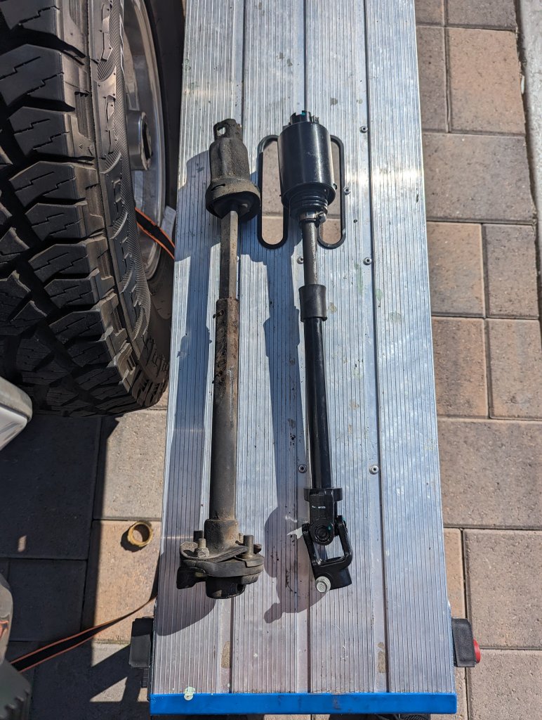

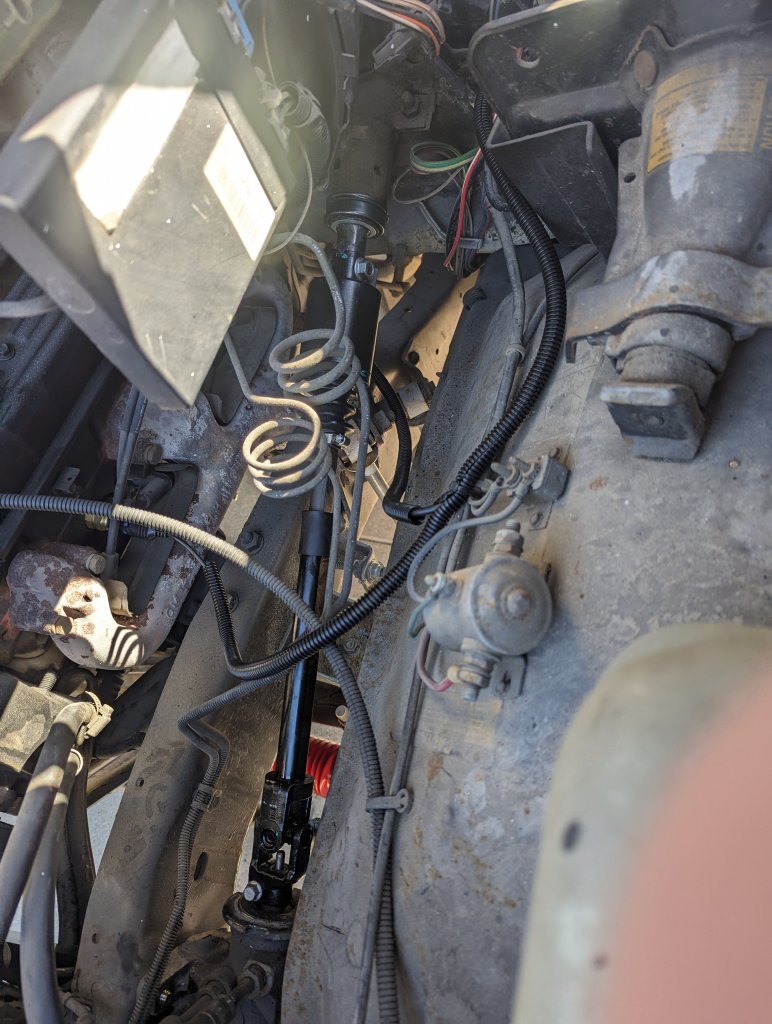

Havened seen anyone mention this here. I just swapped out my old rag joint steering shaft for a C3500 steering shaft. C3500 steering shaft has a u-joint connection at the gear box. Safer than the XJ swap since the connection at the column is with a normal cross bolt compared to the clamp style of the XJ steering shaft. Steering play has been drastically reduced with the C3500 shaft.
