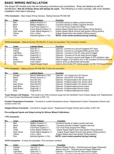

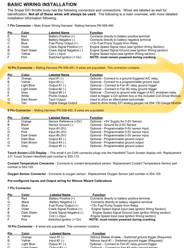

Im assuming your in the 10 pin connector, in the yellow

That’s correct.. A&E are the ones I need help with.

“A” is a ground input telling the ecm to increase the iac to compensate for the compressor load. You would need to use the 12v supply to the compressor clutch to close a 5 pin relay. Then supply a ground to pin 30 and connect lead “A” to pin 87.

“E” is used for engines reaching high enough rpms that compressor clutch need to release to prevent damage. Im pretty sure thats above 6,500 rpm.

Appreciate your help man! I got it wired up, but still not finished with the install.
