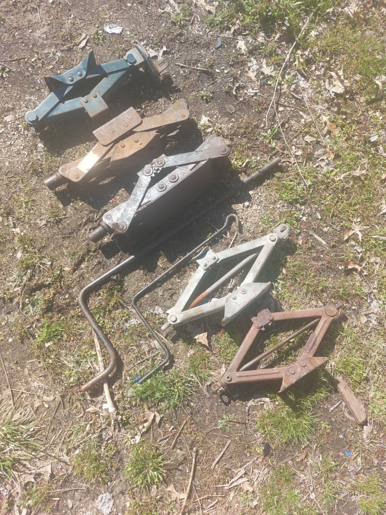

Go bigger! The little ones fold over if you are on any incline,and you dont get to pick where you break down at. The bigger ones are more usefull overall. The little handle that comes with the little ones,don't have the reach or leverage you need. Pictured 2 generic little ones 2 Napa, 1 Mazda pickup factory jack ( top) the Mazda jack is pretty decent and the Mazda,Napa jacks come with a handle long enough to get under the truck. The handle you pictured is is only about a foot. I measured,the Mazda has 2 foot of reach before the bell crank,the Napa has 3 feet,factory has 5 feet.
