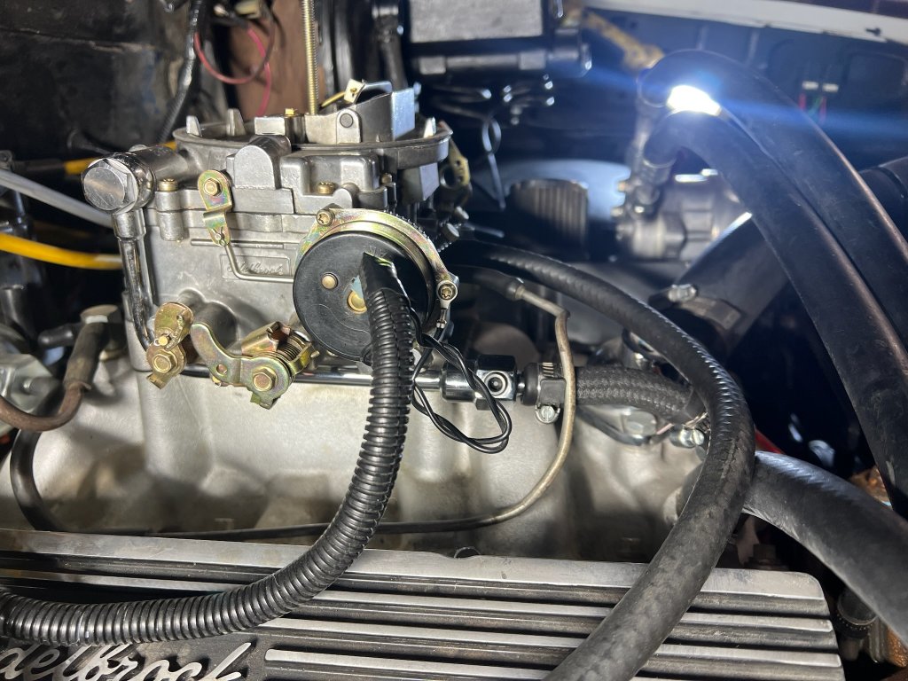

Easton put an Edelbrock performer with electric choke on his about year and a half ago when original Carter started spewing gas everywhere. He loves it and we did nothing to it other than slap it on and start it up. Truck runs great, and he loves the choke.
