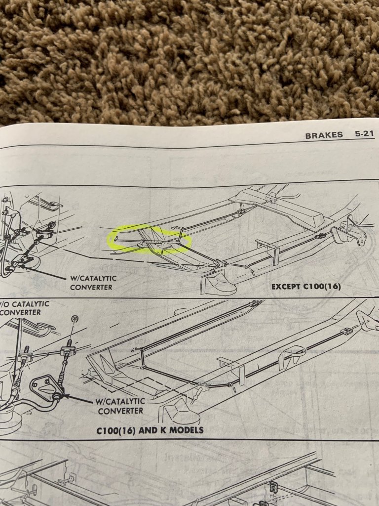

Hi all!
I cannot seem to find an existing thread for my specific application. I did find some but for different frames and/or for a 4wd. . .
I have an 81 C30 Dually, Parking brake cables run up each side of the frame rail, then I have the Intermediate cable that 'Horse shoes' around to connect both together. With an equilizer bracket under the drivers floor, which connects to my front cable to the pedal.
I have it all run, however it does not look 100% correct, as I am rubbing on my Transmission crossmember. Functional? yes... I just dont like it.... not sure if I am missing something.
Frame had two of the loop hangers, I have them in the frame up near the Trans crossmember, but everywhere I look on diagrams it shows a third one somewhere on the Trans crossmember, I do not have a spot/hole for another loop hanger to be installed.
Does anyone happen to have a diagram for a 2WD dually? or pictures of one ran?
Thanks!

Maybe this will help (yellow highlight in picture)?
It looks like there should be a longer loop hanger anchored in front of trans crossmember.

This does actually help. So it would look like I am missing the longer hanger. I will see if I can make something up then. . . Thank you!
