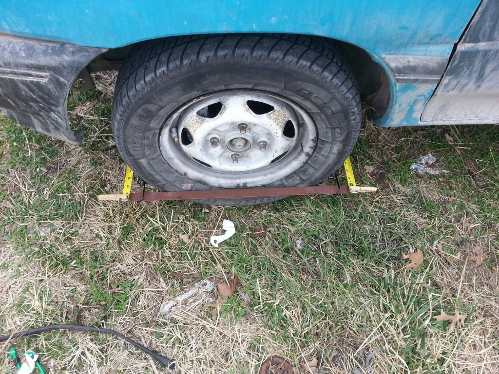

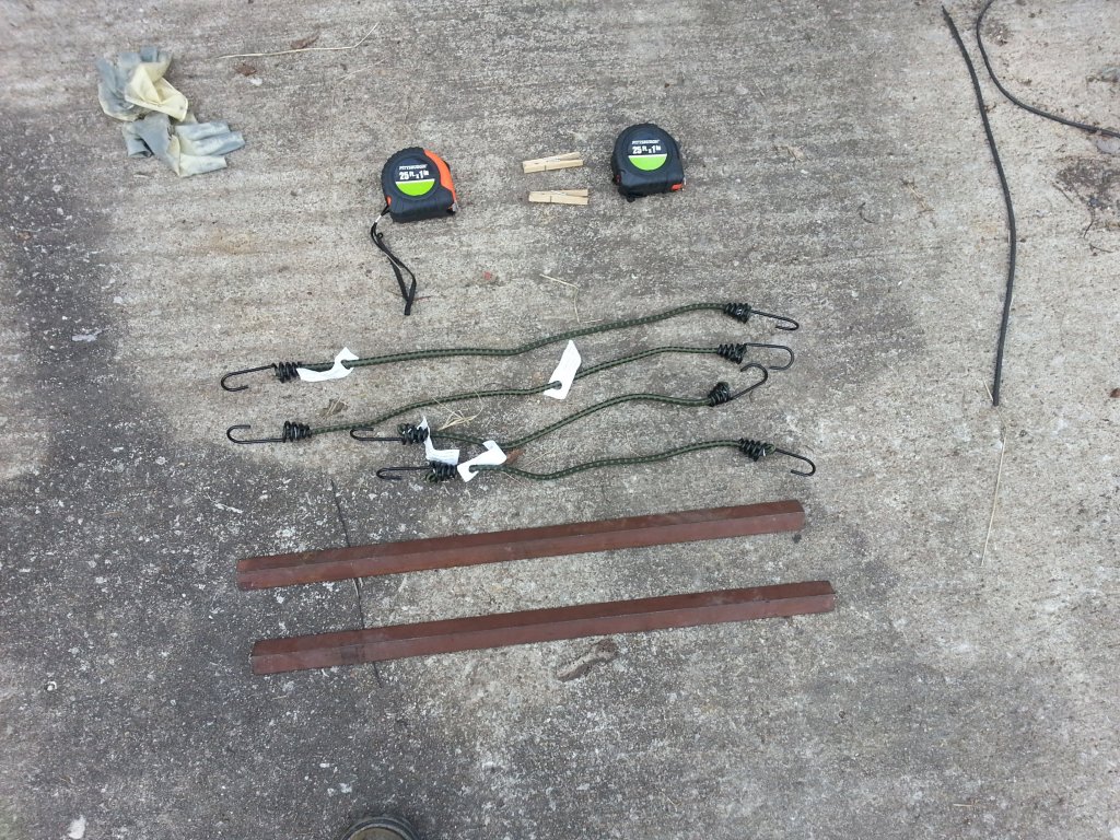

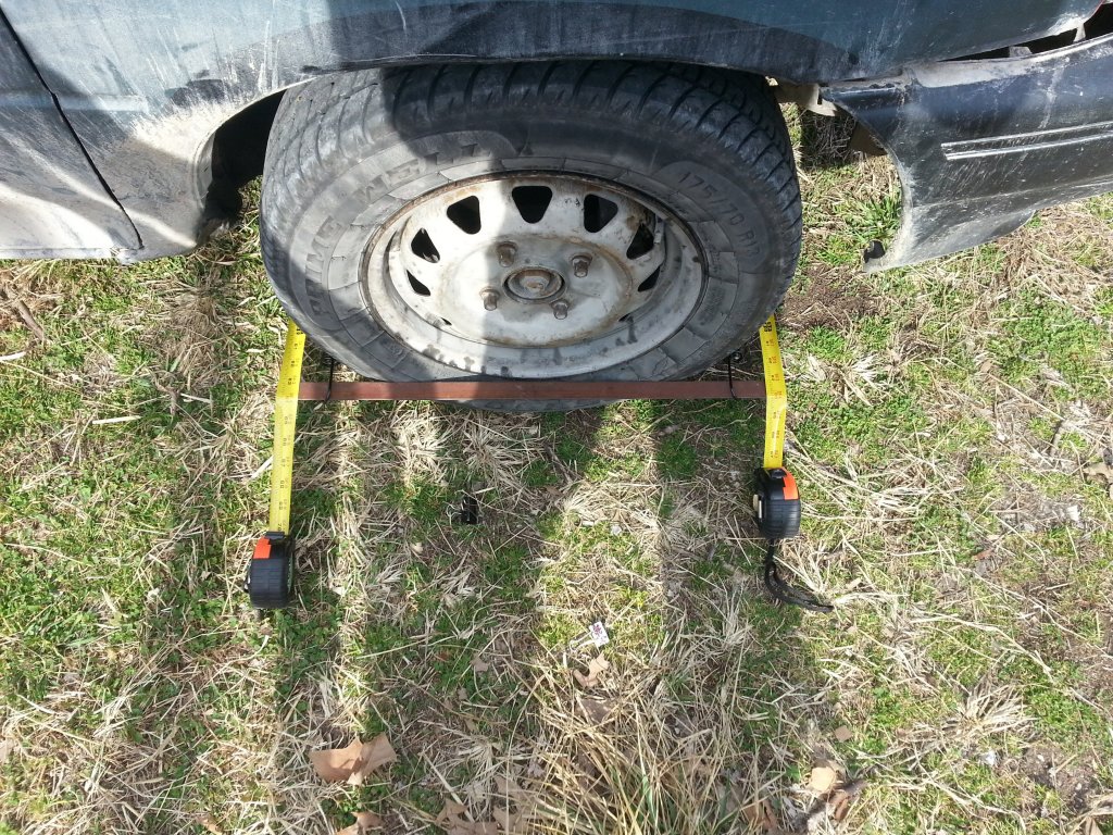

I do my own all the time I'll put up pics and give some general directions in a minute.I now use longer angle the longer the more accurate,you should be able to find alignment specs on line,and conversion charts degrees to inches I always can. The pictures are for toe,which you set last,I have a caster gauge you don't,so we're going to skip that and cross our fingers. You're going to want to check camber first,park the truck somewhere level use plywood squares and or linoleum floor tiles under the tires to make the truck level. Then to be real accurate tape a piece of string and a plumb bob inside the hood opening let it dangle over the fender by the wheel hub put a sponge between the fender and the string as a shim. Measure from the string to the wheel at the top and bottom there's your camber measurement. Less accurate but easier push a level up against the wheel now pull the top or bottom of the level out eyeball the gap there's your camber.

I cam get you more accurate than that,if I teach you how to build a string box, but this is really good enough. If you have to add or remove shims or twist eccentrics for camber do them equally meaning a 16th at the front of the a arm and 16th at the back also. To level your alignment area pull your truck up where you are going to align it put a brick in front of each front wheel use string level or a straight edge an level from brick to brick,that will tell you which side needs shimmed for level and how much,put your shims down throw some sand on them and bring the truck forward.And this all doesn't have to perfect just reasonable close, you never drive down perfectly level roads.The sand is to minimize turning resistance as your setting toe.

Alignment degrees to inches calculator rob Robinette. Type 89 chevy suburban alignment specs they have them at gmt400. I now use 3 ft angle, it's held up by the bungees,same height front and a back of the tire same height on each side about 6 inches up you don't want the tire bulge at the bottom affecting your measurement
