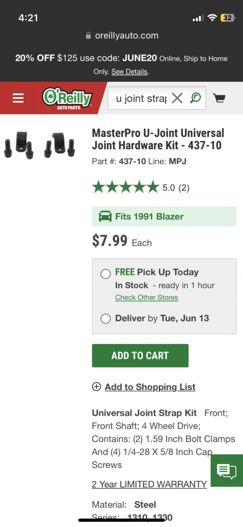

Can someone please tell me what size u joint strap hardware I need? I have a 79 K20, front drive shaft 1.05 U joint. Thanks

This is what’s listed for my ‘91 Blazer which should have the same 10 bolt front axle.

You should be able to source those from the local auto parts store. They have the "Help" line out on the floor but will also have hardware with the u-joints in the inventory area. The cap size should be 1.063 on that front unit. I have an old NEAPCO book printed in my office because I did many joint conversions and installations in my former life. I may be able to find you a number for the hardware in a short time.

Should be a 1310 u-joint strap. Try NAPA
