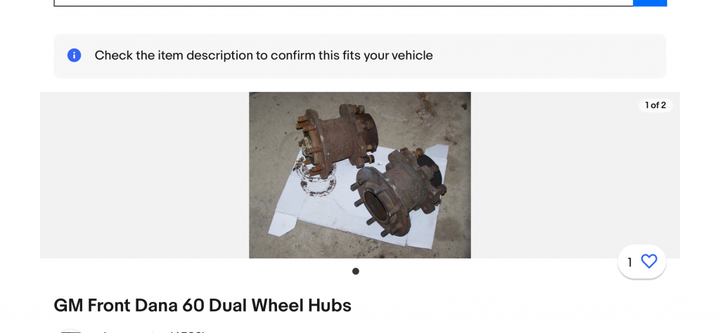

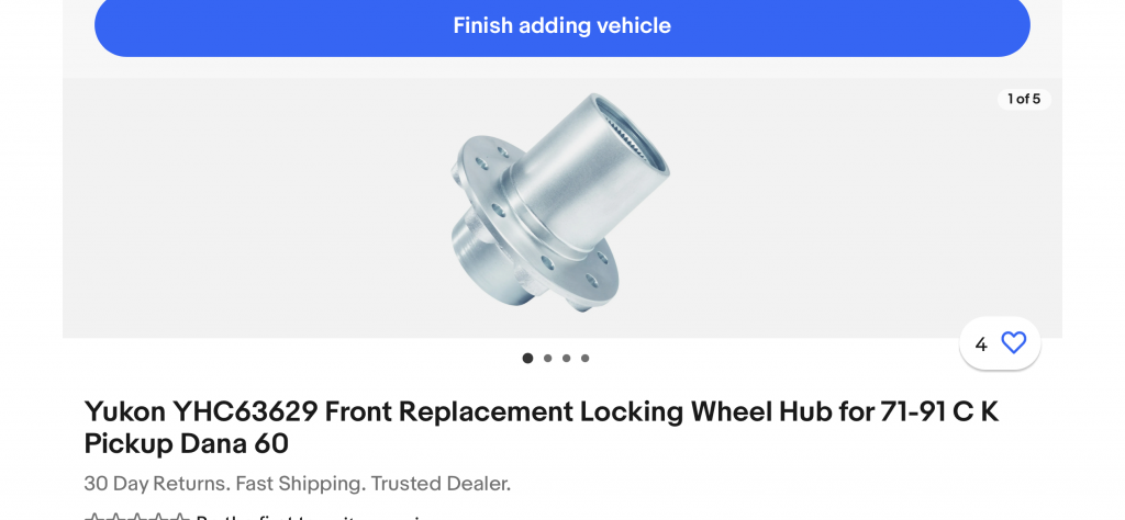

There is a differences in the hub to compensate for the offset of the dual wheels.

Thanks for the replies, yes, my 78 has a Dana 44. I wanted a Dana 60 in my last build and wished I would have done it, so this build is getting it. So, I can purchase a dually front axle and swap out the dually adapter for a single hub. That might work for me for finding a Dana 60 single for the 78 is almost imposable. Thanks again, Frank.

Yes, you just have to factor in the cost. A dually axle is usually cheaper because most people want a single wheel axle and new hubs are expensive. Iirc, the rotors are different as well.
