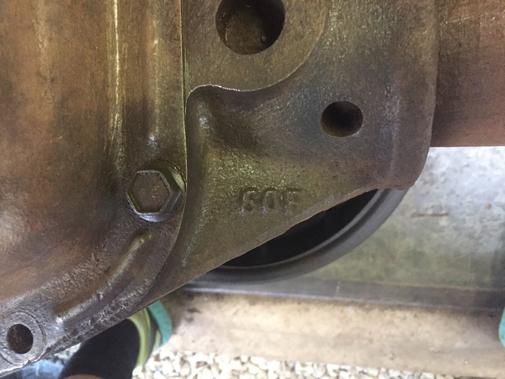

If you look at the front cover next to lower right corner has a size I’d cast in. This is my 80 gmc k3500 Dana 60 single wheel, all my brakes came from rock auto
