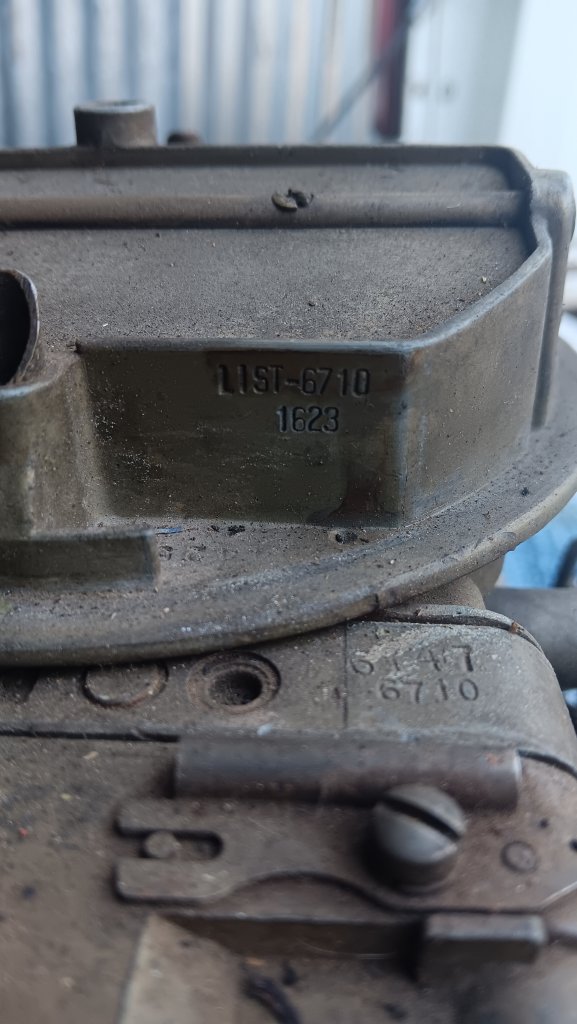

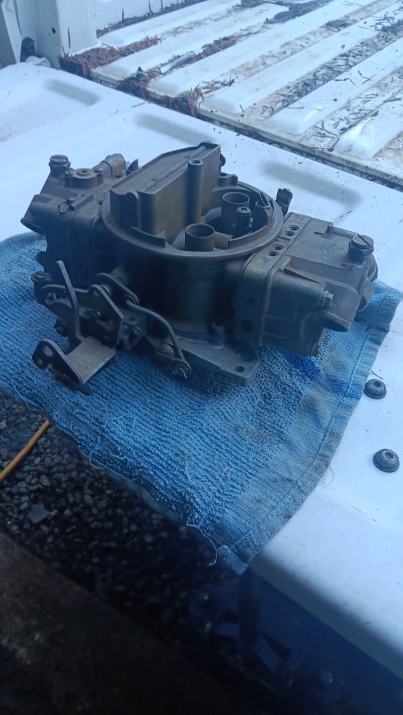

Hope a gas station isn't far away. Are you sure it is original? GM part number stamping?
Maybe im wrong about its origins but here it is. This thing makes me smile
I had never seen a spread bore on a stock GM that's why I asked. If vehicle runs good with it that's great but I wouldn't toss the original Q jet away.
This is all I could find on it

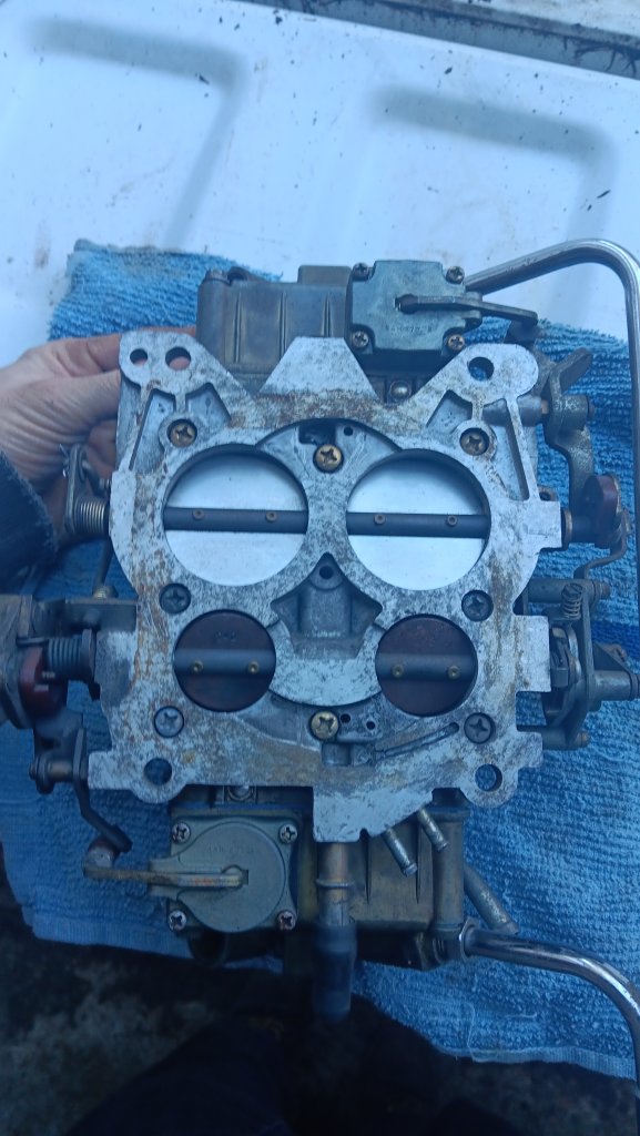

I talked to a mechanic friend of mine who is very old school… he will rebuild completely for about $225
I paid a little over 300 for a stage 2 quadrajet from national carburetors in Florida. Stage 2 is fir a motor with cam, intake and hedders. They tune it for you so it's ready to go right out the box. That guy will save you about 100 bucks to rebuild it. Score!
