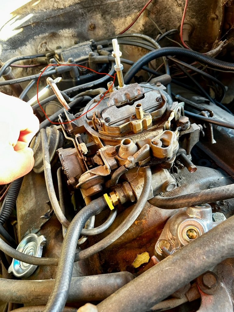

Hi Everyone,
I am trying to get my 1980 C10 Big10, SBC 350 w/quadrajet carb to start. It had been sitting in my neighbors yard from the early 2000's before I bought it this year in April. I've changed everything in the ignition system (plugs, cap/rotor, ignition cont'l mod, coil and plug wires) but I cannot get it to fire up. It does crank and build vacuum but then when I give it gas, it poofs out of the carb and the engine sounds different as its cranking. I checked the timing using the timing mark and checked the position of the rotor to verify TDC. It was very close to TDC so I adjusted it a little bit but still no luck.
I read that the ring on the harmonic balancer can come loose, hence giving an inaccurate view of TDC. Its getting fuel as I have changed the internal filter and fuel pump to carb line temporarily with rubber fuel line.
Any advice?
Also, my dad who once owned an '88 K-5 w/a SBC350 told me to check all the vacuum ports on the quadrajet because they could be contributing to it not firing up. Everything is connected/plugged except the hose in the photo that comes out the back of the carb and into a metal line the turns forward. I also would like help with routing the vacuum lines to the correct locations please.

Is the port capped off on the back where the brake hose hooks up?
