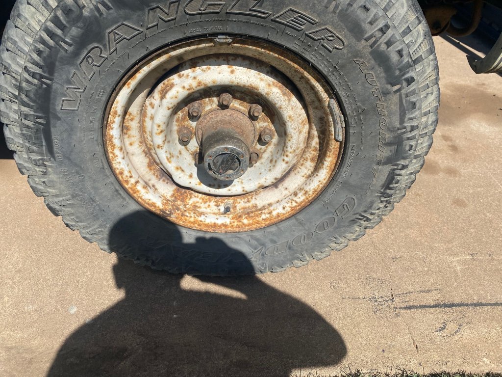

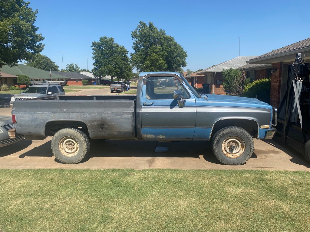

Can anyone identify these wheels?
Deathdog
Aug 2, 2023
10
Oklahoma
Michael
Can anyone identify these wheels? 16" 8 lugs on a 1987 Chevrolet K20. I'm wanting to put beauty rings and hubcaps on.

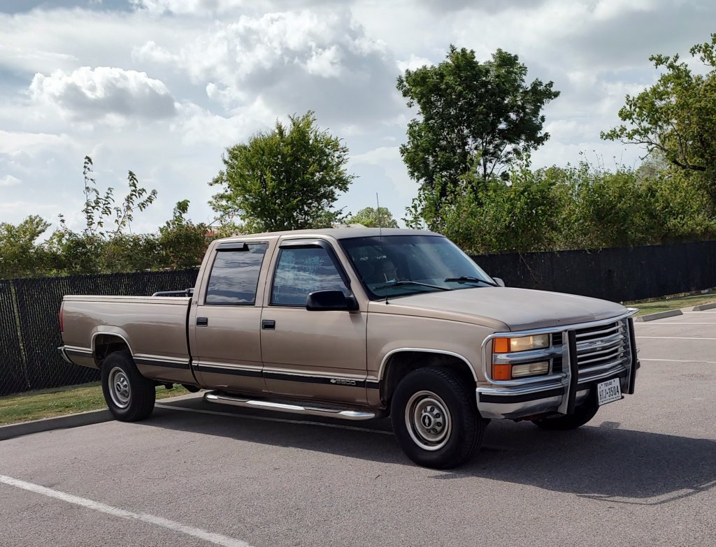

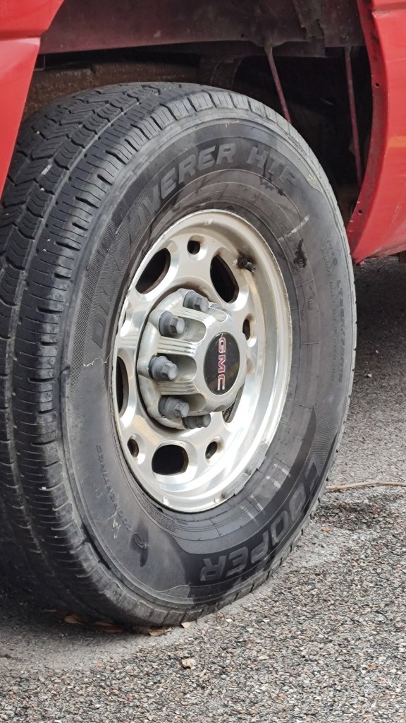

If you can find a later square 8 lugger or an OBS 2500 8 lug or 3500... they're in the local yards around Houston, Texas area. Just not as common as the half tons. The OBS 8 luggers either had plain steel wheels with the flat full wheelcovers or Argent painted steelies with caps and rings. No aluminum wheels from the factory till the GMT 800/NBS came out in 1999-2000. Then you had the PY0 option ones.
First picture is the OBS steelies with caps and rings. I think the chrome cap and stainless trim rings are part of the Silverado package. I'll check my VIN number report and see.... The trim rings option code is PO6. The caps may be in the "decor" package....
Second picture is the PY0s on a NBS truck at the park.
The 8 lug pattern is the same through 2010. Anything newer has a larger pattern and requires adapters. I know guys on GMT400 forum that have been through this on their tow rigs and 2500 Burbs.
First picture is the OBS steelies with caps and rings. I think the chrome cap and stainless trim rings are part of the Silverado package. I'll check my VIN number report and see.... Second picture is the PY0s on a NBS truck at the park.
