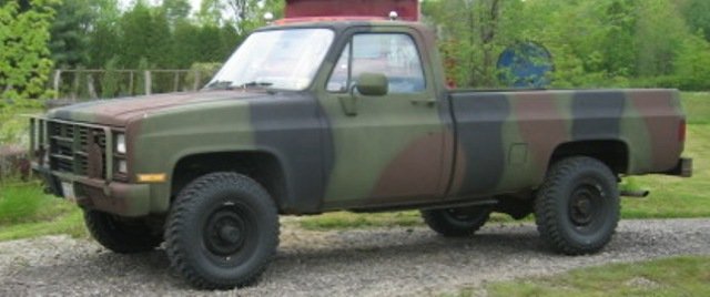

Like these?
You can put nominal 35s (315-75-16) on 16x10 OE lookin steelies (or 16x8 but that’s a tad narrow imo.)
Or US wheel makes 17-20” steelies and Detroit steel wheels makes 18-22”? steelies.

Like these?
What wheel are you running? Those look great. Are those 20” or 22”?
6,096
10,234
Washington
Do the hub caps snap on or sis you have to make provisions for them?
The mfg offers an option to drill and tap for metal clips that hold the hubcaps on. The rims don’t have the “bumps” on them like OE rims.
Check out their website. It’s pretty informative.
