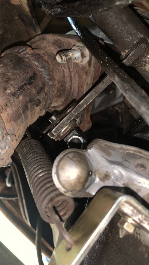

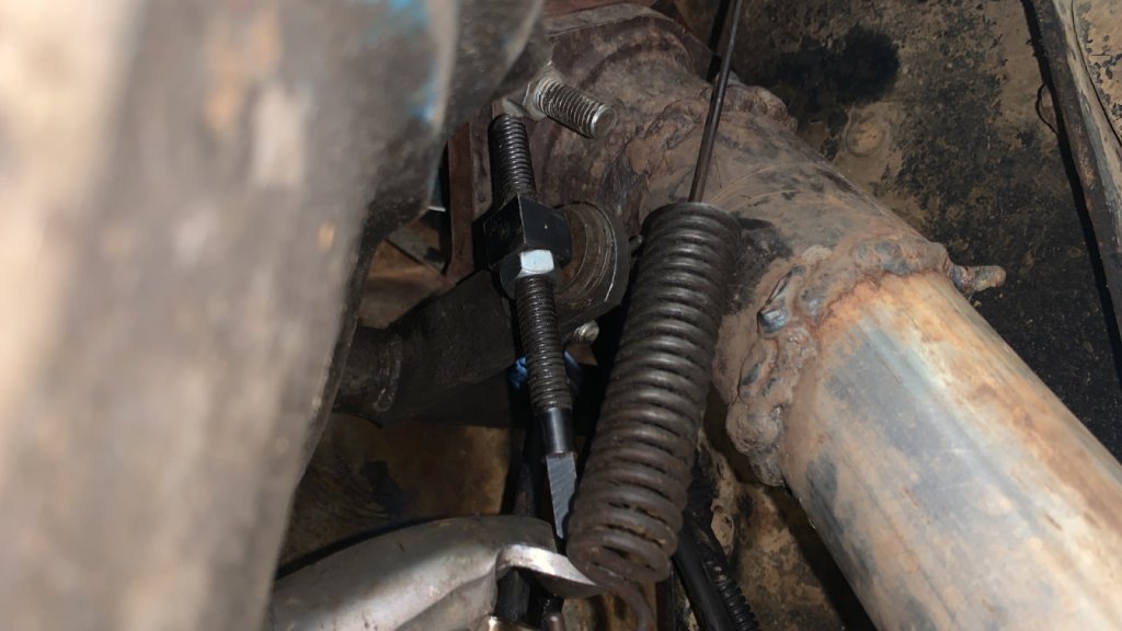

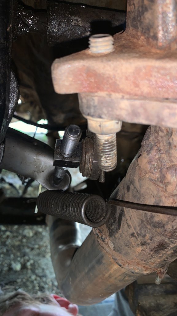

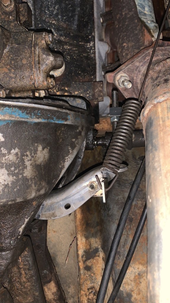

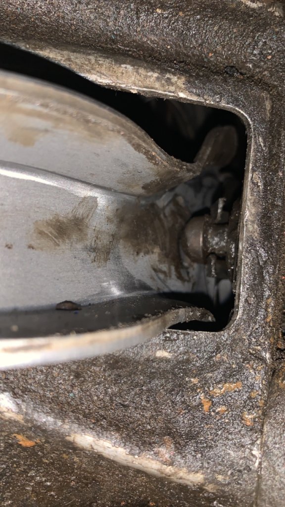

As you can see in the photo the fork keeps coming off the stud and it rotates around and each position of the fork makes a different adjustment. Can I use a screwdriver and push the retainer tighter to the fork to hold it? Also pedal has no free play after it returns, I have to pull it up to same height as the brake pedal. All the linkage inside the cab has been greased and with the adjustment rod removed the pedal moves freely to the floor and back up by hand.
