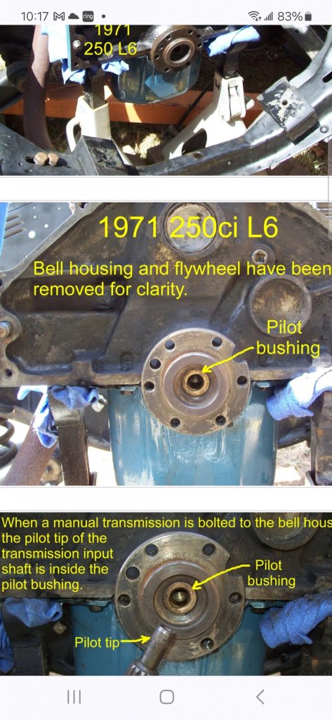

Like everyone has said it's either the throw out bearing or pilot bearing/bushing. I will attach a picture to show where the pilot bearing/ bushing is located

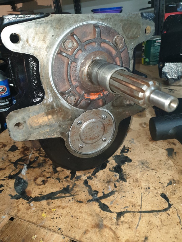

Looking at the sm465 trans, this is the input shaft, the bearing is behind the 4 bolt cover that the clutch release bearing slides on. That cover/retainer only goes on one way as there is an oil way in it to feed the bearing.
I agree with prairiedrifter check out GebBuilt on youtube there is a 3pt video on a full rebuild of the SM465. Worth having a couple of beers while in front of the TV.
