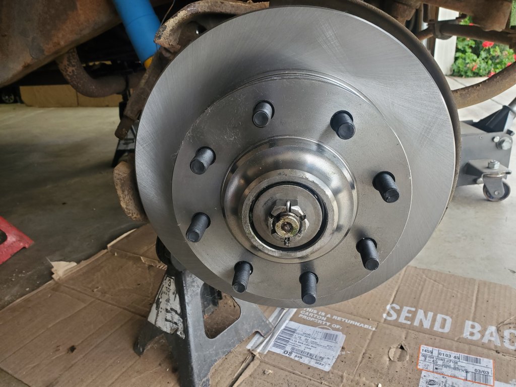

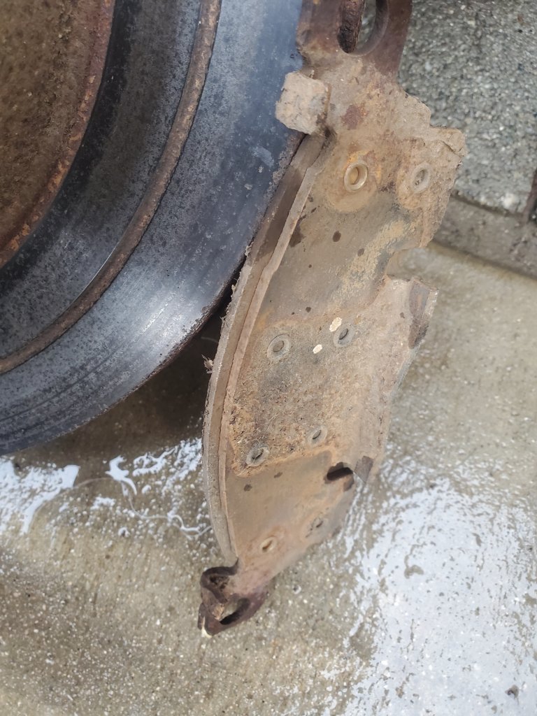

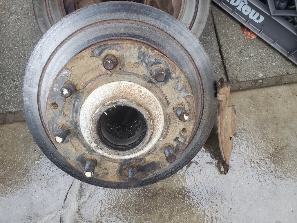

I don't know how to check the booster so I will do that next.
I blocked off the 2 outlets on the MC, and when I do that and pump the brakes I get pressure. Felt like typical pumping brakes in a car turned off.
I only replaced the brake pads and rotors.
I'm not getting any fluid to both rear. I checked the proportioning valve and I believe I got it centered. Last night I disconnected the rear line where it connects to the proportioning valve, and ran compressed air through, and still nothing out the rear bleeders. No air, no bubbles, nothing.

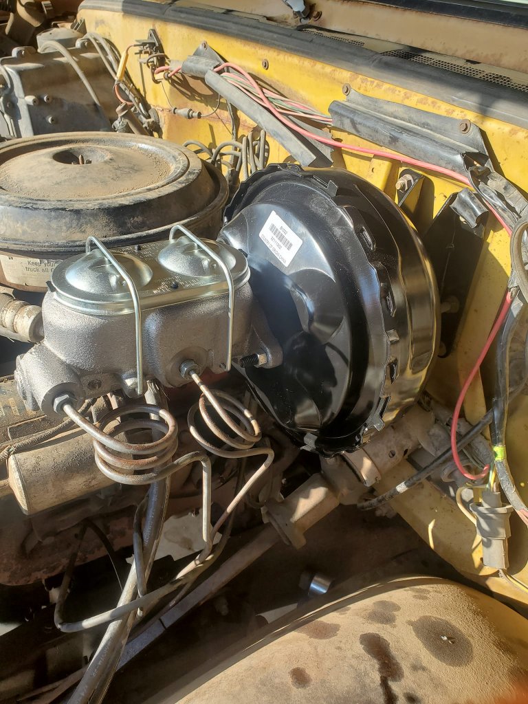

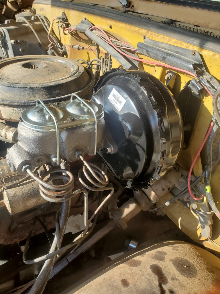

Here's an update
Thanks to everyone that helped. Replaced the booster, and that fixed the hard brake pedal. No more standing up on the pedal to stop.
Continued to not build pressure though, so new master cylinder (yes I bench bled it) and now the truck stops.
My brake pedal still feels extremely low to the floor and very squishy, but stops. I've made a huge improvement. Next step, I need to address why no fluid is going to the rear brakes, and why my brake light inside is flickering on and off.
I'm going to make sure proportioning valve is centered, and replace the rubber hose in the rear and go from there following Fast and AZ instructions.
This MC is what NAPA said was for this 73 c20 3/4, but it's different. The outlets are switched so I had to gently nudge the brake lines to work. With that said, would I have issues, or should I look for a different MC?

Make sure master is correct for the vehicle. Could have had a wrong one on it? Larger line and reservoir goes to the front 1/2. Obviously, there is air in the rear 1/2. Need to fix that problem next. If the system is completely dry it may not self bleed. Get a helper and try bleeding it. Don't dwell on the brake pressure warning switch, it is working as designed. Fluid in the front 1/2 and none in the rear will turn the lamp on, differential pressure.

I believe it's the right master and booster. It's a 3/4 ton truck. Although I had to take the word of the local NAPA.
