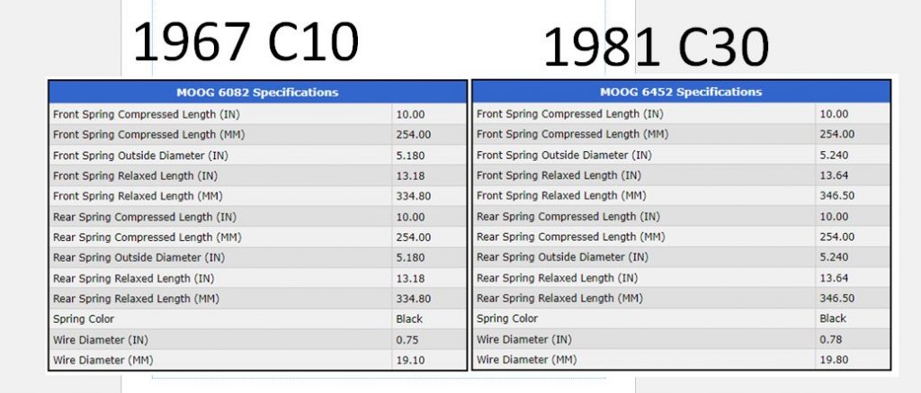

To add further, I may have a set of springs from a 67 C10, wondering if anyone has tried throwing those in before. According to rockauto they are just a touch smaller then the stock c30 springs.

As for your suspension plans, I'd do a spindle up front to maintain ride/ geometry as best as possible. You can always trim a coil or install a drop coil if you want more later.
I've seen people address the pinion angle various ways; nothing, shims, 1 piece shafts, drop carrier bearings, etc.
If for some reason you change your mind and decide to go low, as far as I know, only Empire Fabrication notch maintains the frame strength as original on the C20/30. However it costs 4x as much, weighs 3x as much, and takes a lot longer to install.
