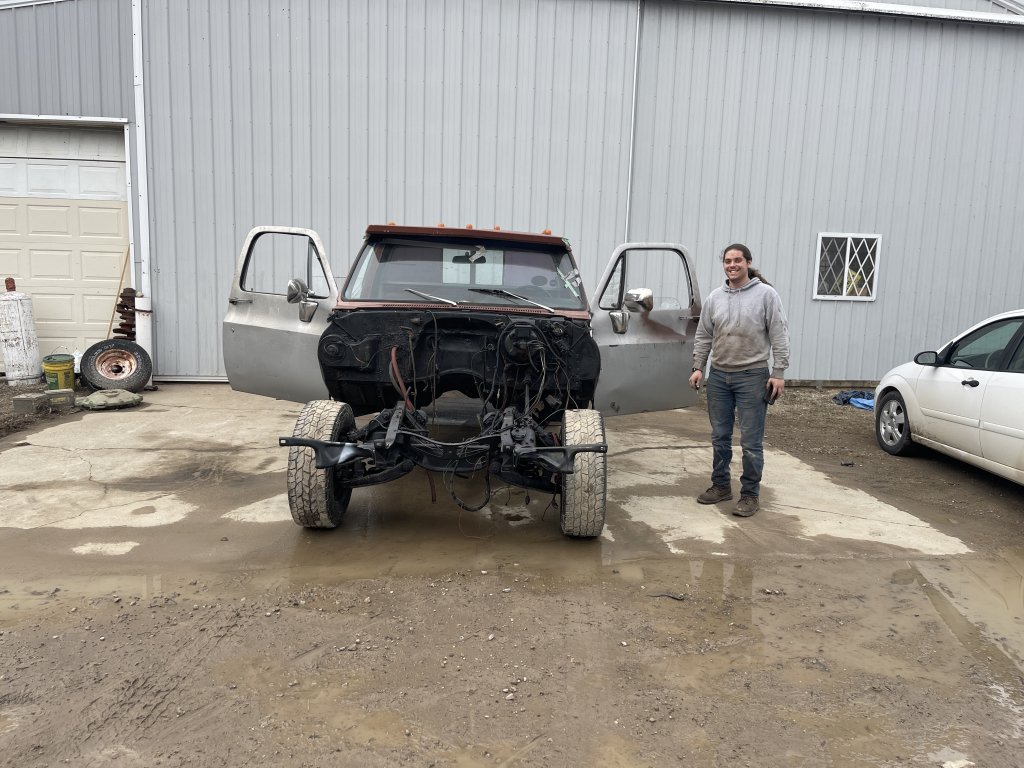

My son and I are planning on doing an auto to manual swap in his 83 C20 from our parts truck which is a 76 C20. The transmission crossmember was destroyed when it was parted out.
Questions
1. Is the crossmember specific to the SM465?
2. Will the cab need to be lifted to install the manual clutch z-bar linkage?
Any other advice?
We do have an NV 4500 out of an OBS available. Would that be more difficult to swap in. We have a fresh 350 V8, that is slightly modified.
I attached a picture of the current state of the truck.
