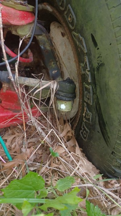

Look at the threads on the tie rod ends does the drivers side show tons of thread and the passenger side significantly less or vice versa? Your column doesn't have ujoints. Personally I'd take the tie rod ends off at the spindle, you do not have to use a pickle fork,all they do is tear boots. Now center the box, point your rotors relatively parallel and straight forward. Now see how much the tie rod ends miss their location in the spindle. You can eye ball how much they tie rods need to move,if it's not a bunch twist the tie rods put them back in the knuckles. Set the toe with a tape measure. The other alignment specs won't change and toe is easy to set with a tape measure. To separate the tie rods without a pickle fork back the nuts way down but not off the threads put a pry bar trying to push the tie rod so it pulls the end out,smack the side if the spindle hard with a hammer it will pop apart.When you twist the tie rods twist the sleeve one end is lht other is rht so the ends go in and out proportionally. I just went and took a pic for you that dot of white out I put on the spindle,that's where you smack it with a hammer. I gaurantee your 99.9 out of 100 times I get it without a pickle fork and I don't tear the boots.
