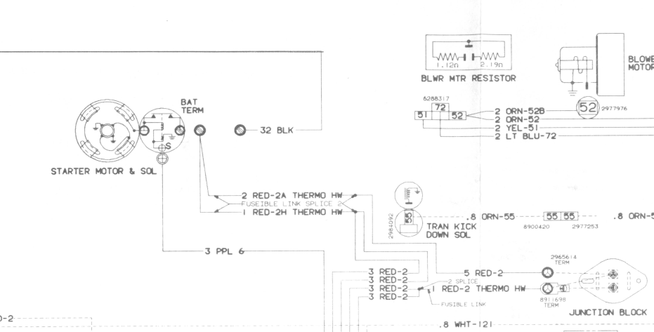

What gauge is the wire going to the starter solenoid? 84 Sierra 350/TH400. I need to fix mine so want to get the right stuff. Thanks
