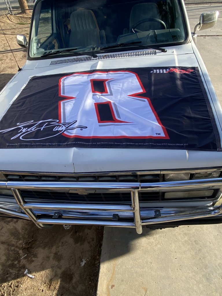

Hey y’all how y’all doing I’m new here but I burnt my 700R4 on my 89’ Suburban 4x4 and need to find a replacement and I had my friend who has bunch of suburbans say he has a TH475 with 8k miles on in and replaced filters and the works but I don’t know if it will fit. I wanna know if it will be a direct bolt on Because this is for my daily driver too and right now I’m stuck in first and it sucks not being able to go past 35 mph :(
So if anyone can tell me anything I’d really appreciate it
Thanks y’all
