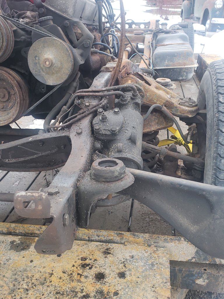

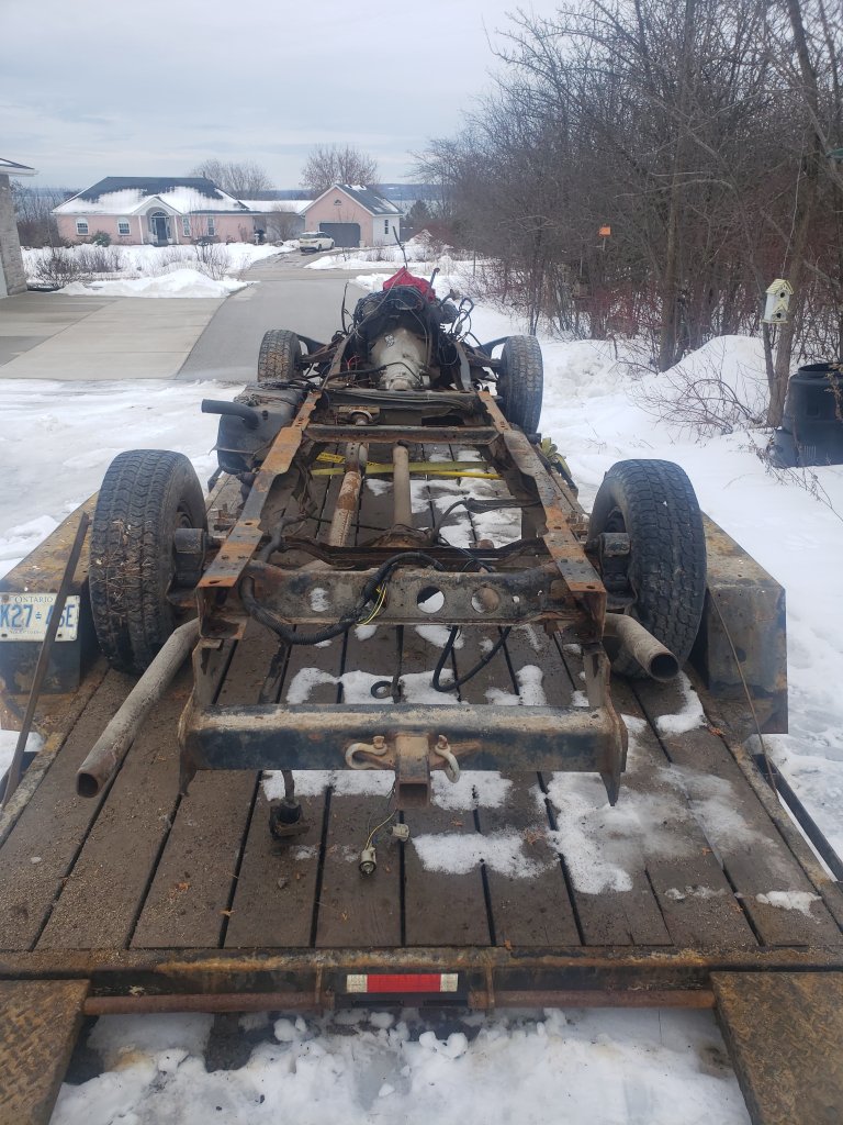

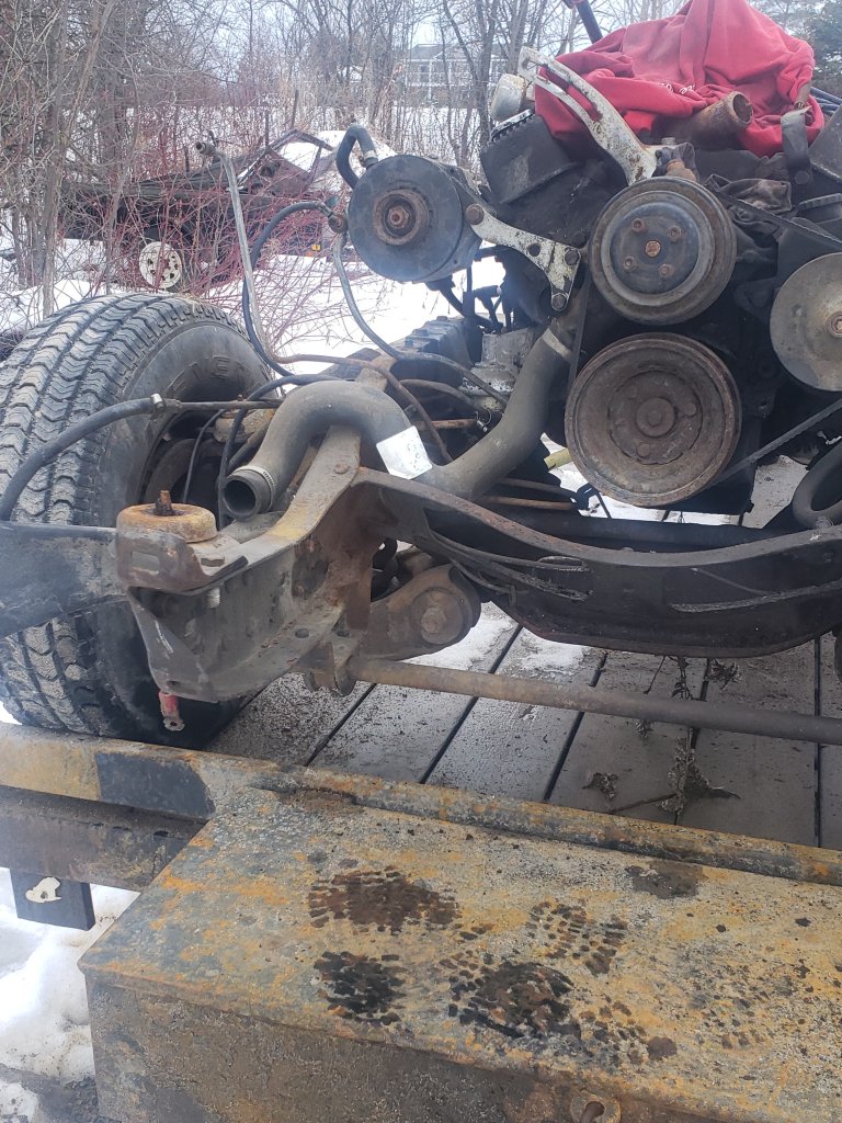

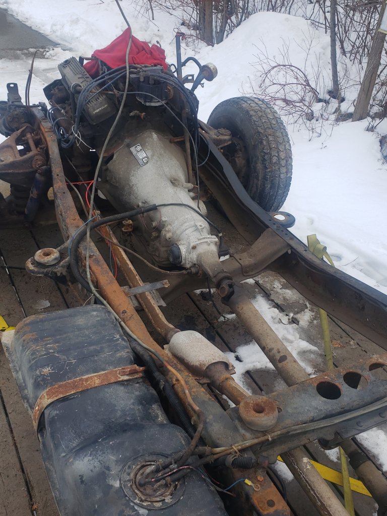

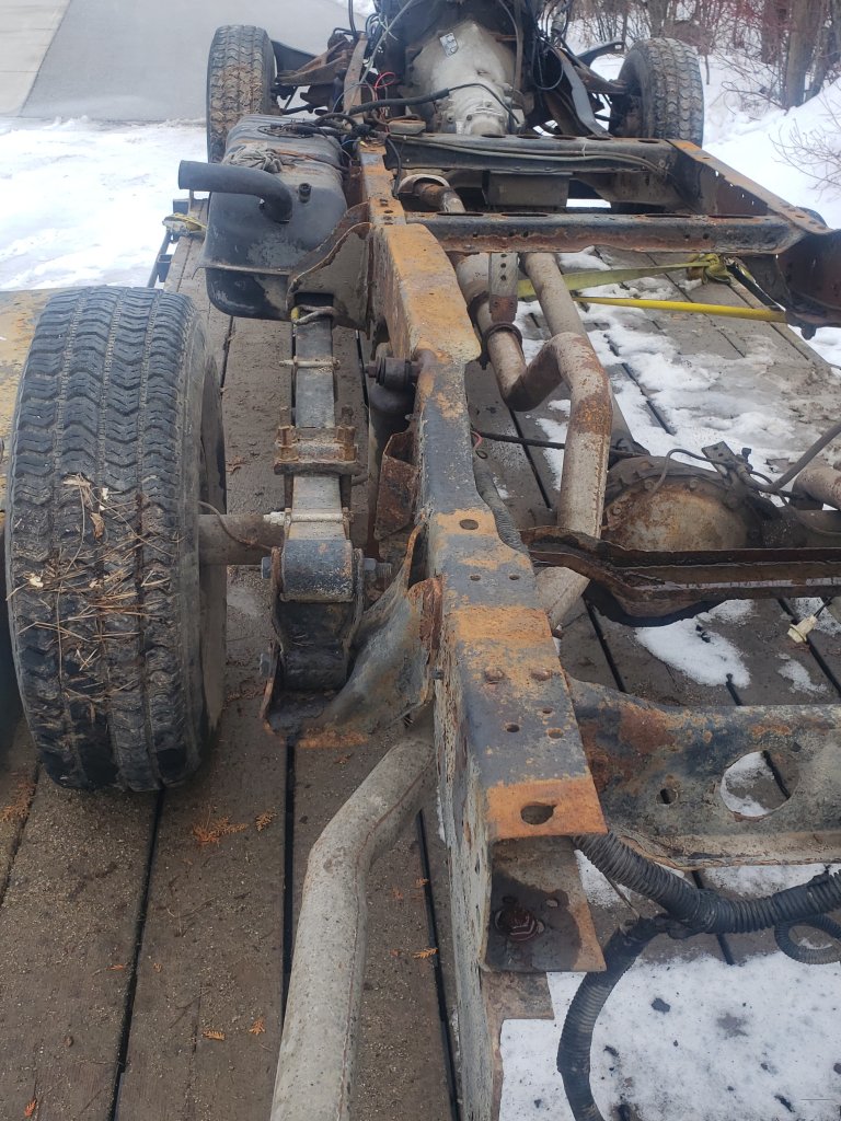

who can help identify this frame?
PapaD
Dec 23, 2024
owen sound
dennis
sierra 1500
I purchased this frame and beleived it to be circa 1982 GMC sierra... but can not verify anything!
Block is 350.Cast# 3970010. stamped numbers on block in front of passenger head are "161404867 K09 03 CMJ"
can not find any frame markings. 15" rims. wheel base 132". pics attached?

'81+ frame. Engine is pre-'87. The rear axle is a 12 bolt, which should mean pre-'83.

The vin should be on the top of the passenger side frame rail, just a few inches from the front cab mount towards the engine.

Thanks Strick and Bucket.. it looks like you have it narrowed down 81-83. We still have a few salvage yards around.. but info isn't realiable.
This is a solid frame and I want to bebuild it for 1948 GMC body...so need to order as accurate as I can. I tried to use 350 info.. but CMJ code showed up as 1974?
thanks...but I scrapped and cleaned with no luck. Maybe after sandblasting something might pop out!
