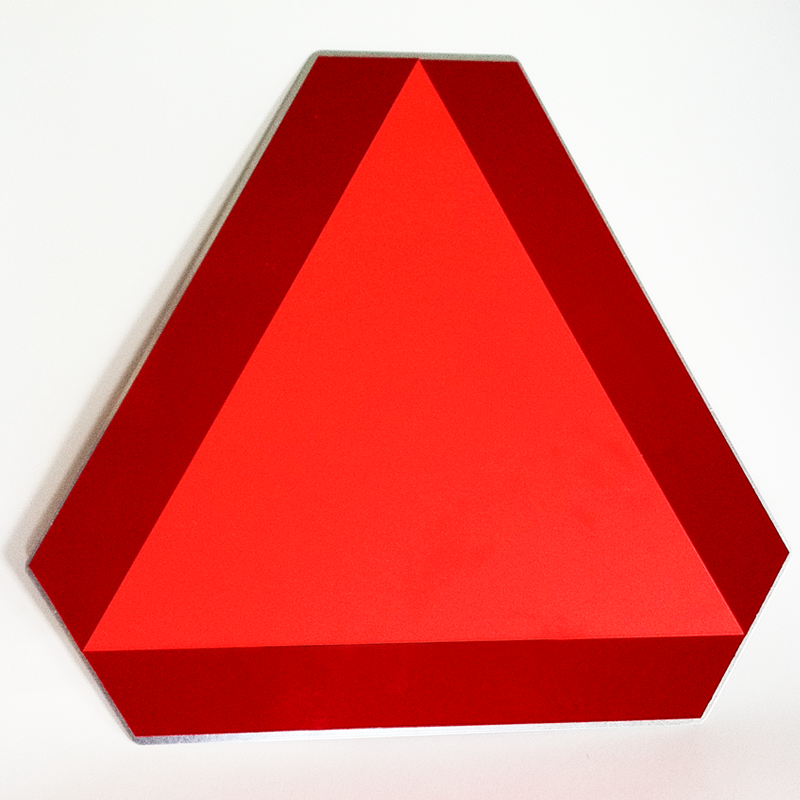

Slap one of these bad boys on it and the weight limits disappear (for legal reasons this a joke)

Slap two of these plates on and say goodbye to fees as well!

I haven't been down there much at all in the last couple years, but didn't VA get rid of the farm tags that you could just buy at the store? Last I knew, there were new laws that were going into effect that put heavy regulations on what you could use those plates on, and you were going to have to buy them at the DMV to get them.

I'm not sure, but there are loads of them around still.
Someone i know got some off amazon and hasn't ran into any issues yet. It's been like 6 months on those plates.
