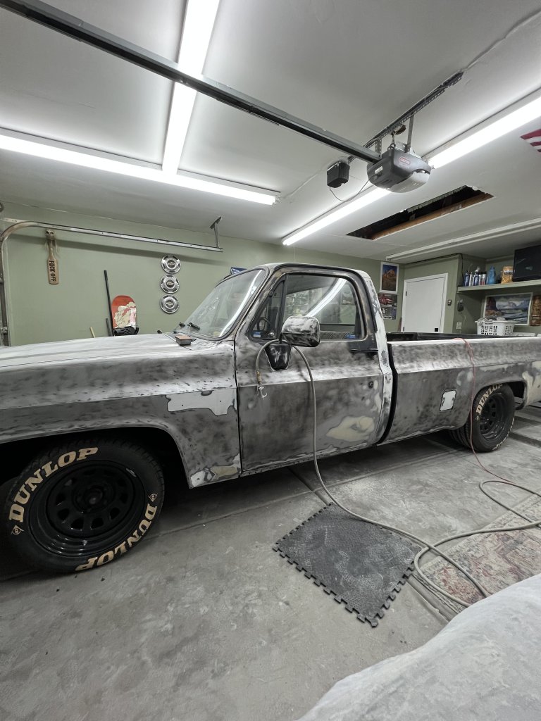

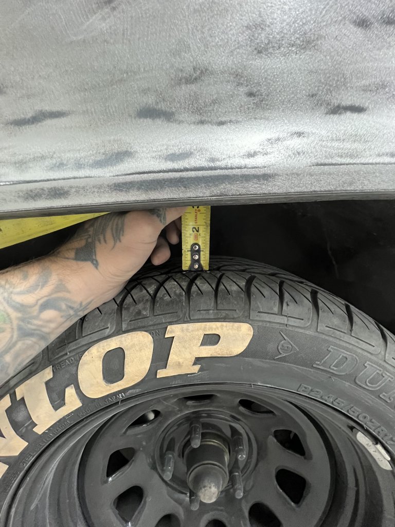

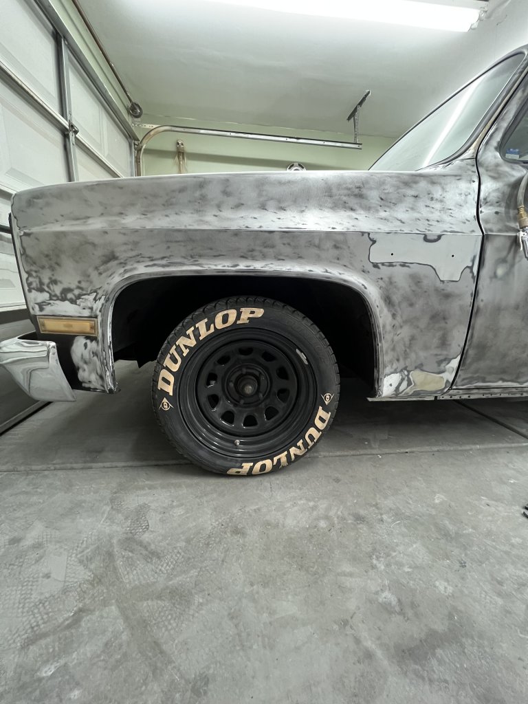

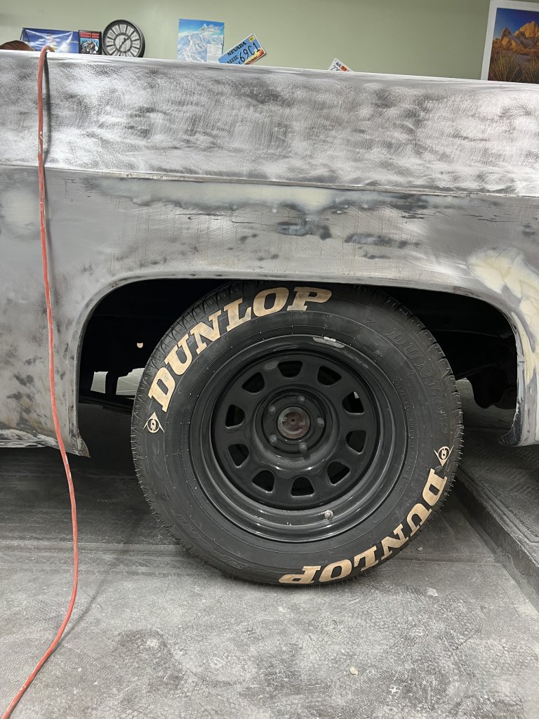

what size drop spindles won’t cause a tremendous amount of rub? Photos attached for reference of how it sits now. Going for the same fit or close as possible to the rear.
Thinking 2”? 2.5” might be too much?

I'd go 2.5" you can always put a thicker isolater under coil spring if needed
