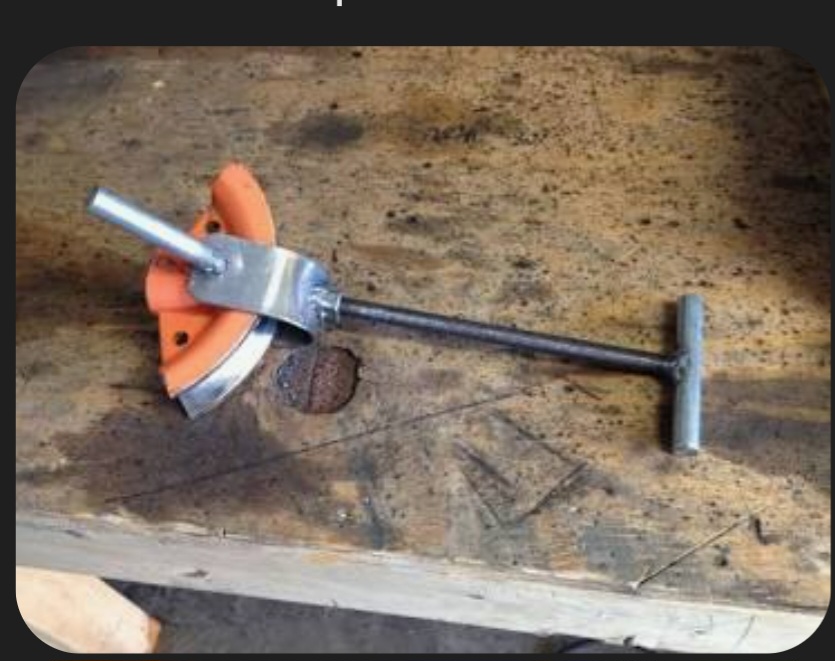

Pipe and tubing are measured differently so you need to modify the dies to fit tubing. And then .pack with sand and make a clamp for the die to hold the middle of the bend in place so it doesn't rise in the middle And kink. The follower rollers need to be remade with pieces of split lengthwise tubing. Lots of other tricks I probably haven't seen yet see the orange one ground for tubing and a homemade clamp
I saw on YouTube (like you suggested) bending in small increments moving the tube in 1/2 inch to 1 inch at a time it also helps to prevent kinking. I seen a few about the sand. A couple of videos on using a smaller die and a top clamp. I guess we'll see one day when I want to waste some pipe...lol

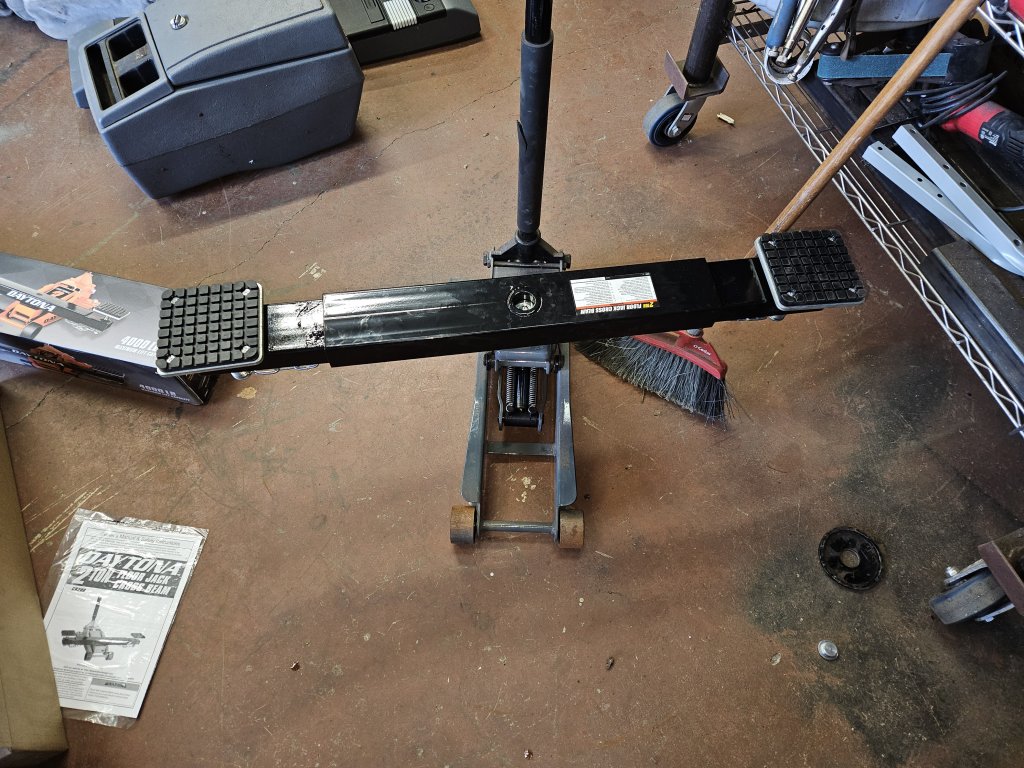

Got this at Hobo freight today. I have been looking at one for awhile, had a coupon so I got it.
Ive had one of those since the square was my daily, used it about 3 times so far.... it has lived in my burban for many years.

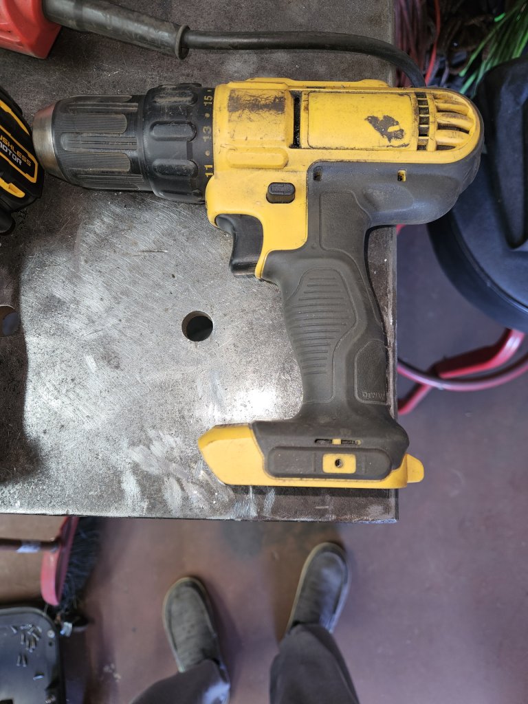

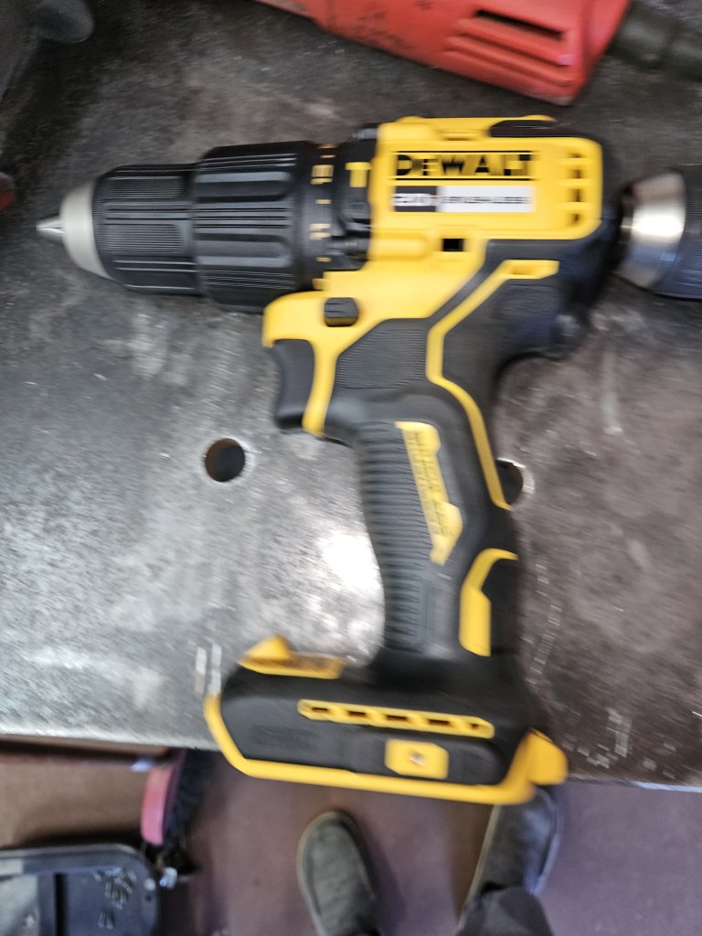

I smoked my old cordless drill a couple of weeks ago. It still works, but has no where near the power it use too. So I replaced it today.
