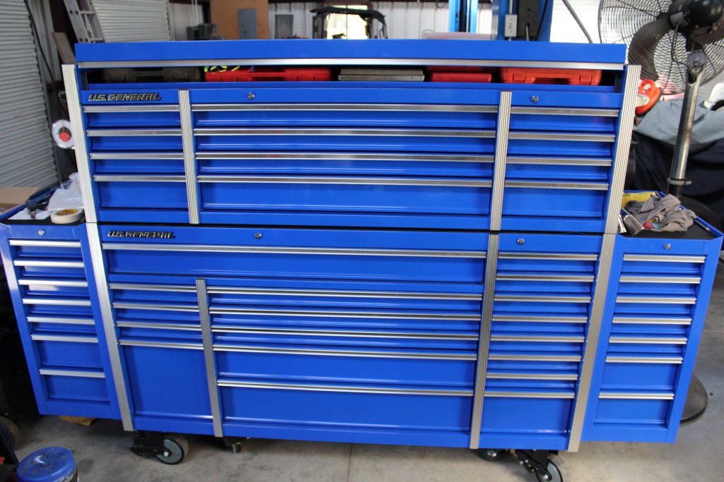

I didn't get new tools but new toolboxes .
