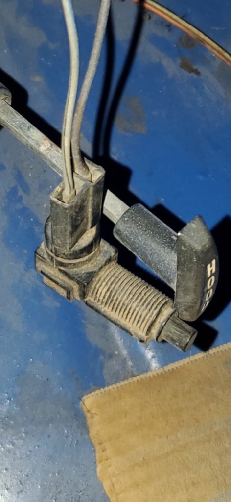

I don’t think the truck did. It’s a ‘78 and as far as I know cruise came out in the 81+ years, correct me if I’m wrong. But the column was out of an ‘86 and may have been in a truck with cruise.Does the truck have cruise control?
Orange for the power feed into the switch and white for the switched power to active the brakes lightsDefinitely looks like brake pedal switch but I thought that was orange and black wire??
My 79 had factory cruise. My 84 with a 700r4 has two brake light switches if I remember right. One for lights and one for torque converter lockup control/cruise.I don’t think the truck did. It’s a ‘78 and as far as I know cruise came out in the 81+ years, correct me if I’m wrong. But the column was out of an ‘86 and may have been in a truck with cruise.
Not sure what transmission he had, but I’ll bet you’re right, it’s probably for cruise control and possibly lock up torque converterMy 79 had factory cruise. My 84 with a 700r4 has two brake light switches if I remember right. One for lights and one for torque converter lockup control/cruise.
Is the brake light switch in place?
The truck could have had a th350c which has a locking torque converter.
Hello Was this switch linked to the hood release? No lights come on when you pop the hood And I don't think our older trucks have a warning light when hood is in half way mode. About the cruise, I was thinking our new 1979 Jimmy had cruise control but after this many years and now having an 85 pickup with cruise, I might be mistaken. Good luck figuring it outI don’t think the truck did. It’s a ‘78 and as far as I know cruise came out in the 81+ years, correct me if I’m wrong. But the column was out of an ‘86 and may have been in a truck with cruise.
