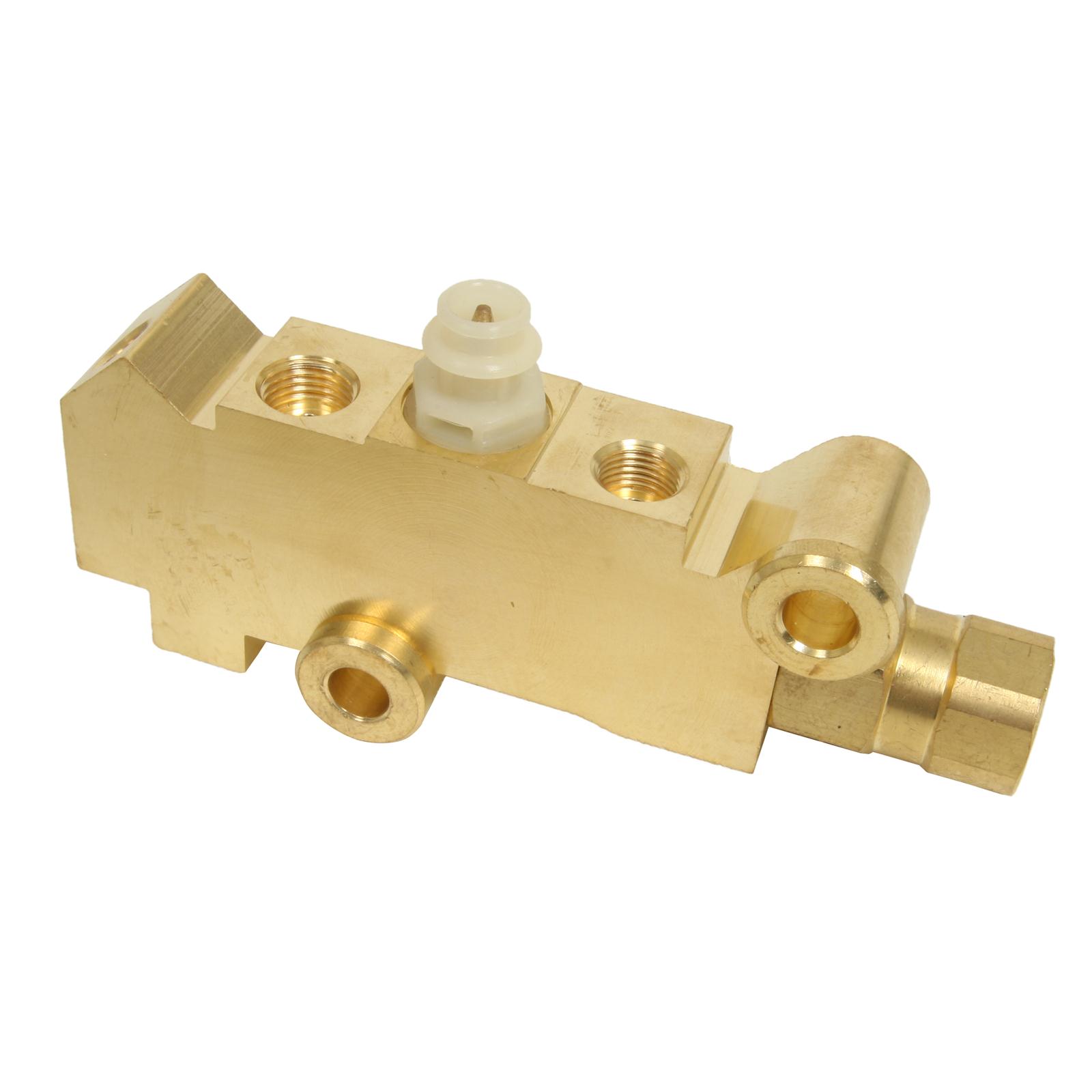

@Goldie Driver that looks correct. However, I've never had much luck with buying those kind of hard parts from Amazon (always seem to get cheap parts)
Summit lists a few options that "fit" our trucks but they also list the threads so I'd try getting one from them with the correct threads. For <$60 it's worth a shot.

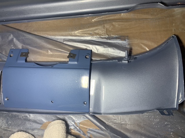

Just use the little panel from under the steering column. It may not be dead accurate to the paint that had been on the outside, but no farther off than the variances from truck to truck when new. As long as they can get it reasonably close to that panel, it should be fine for a complete paint job.
Ha. That’s the exact piece I took off a bit ago! Paint is perfect on it and I want it to match the interior anyways. This is the difference. Lol
Huge difference, it was good to hear they are going to fix it! That's the reason I'm also using Tamco their customer service is awesome. I'm also happy I wasn't trying to match old color on my truck.
Jeez, looks like they forgot to add ANY blue
