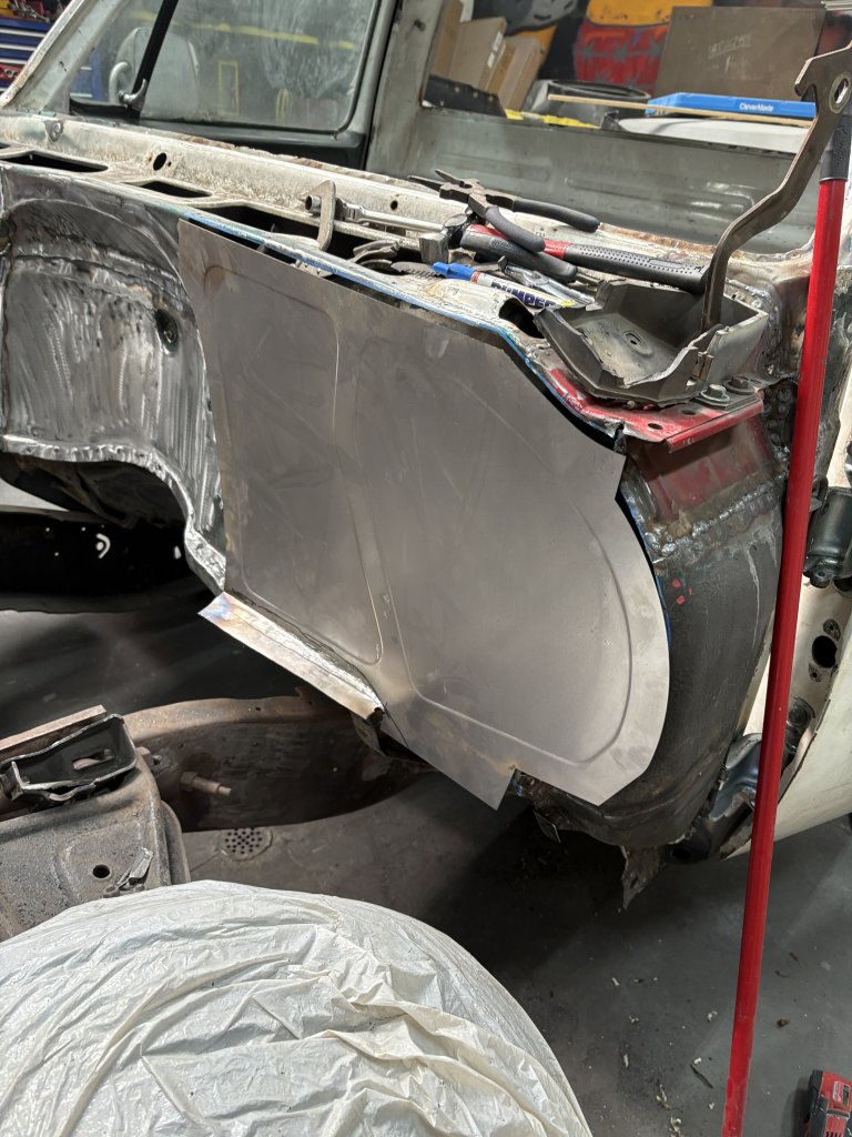

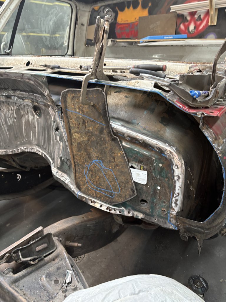

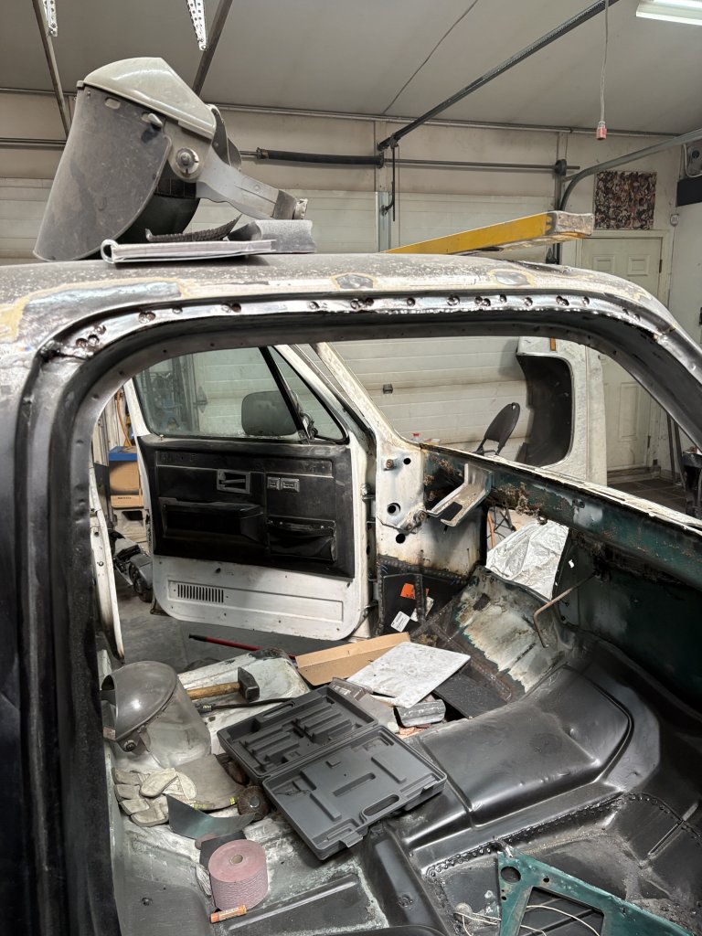

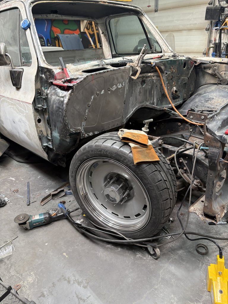

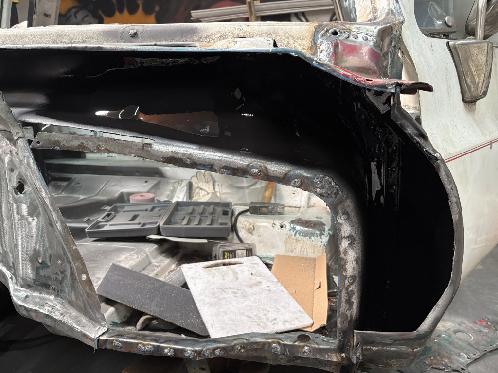

Spent the last couple of weekends Attempting to stay focused on just the firewall- cutting it apart, fabricating the brake support plate, modifying the new driver side firewall but after painting the interior of the rain tray today started preparing for the roof skin removal, popping out and busting spot welds along the seam of the door trims.
