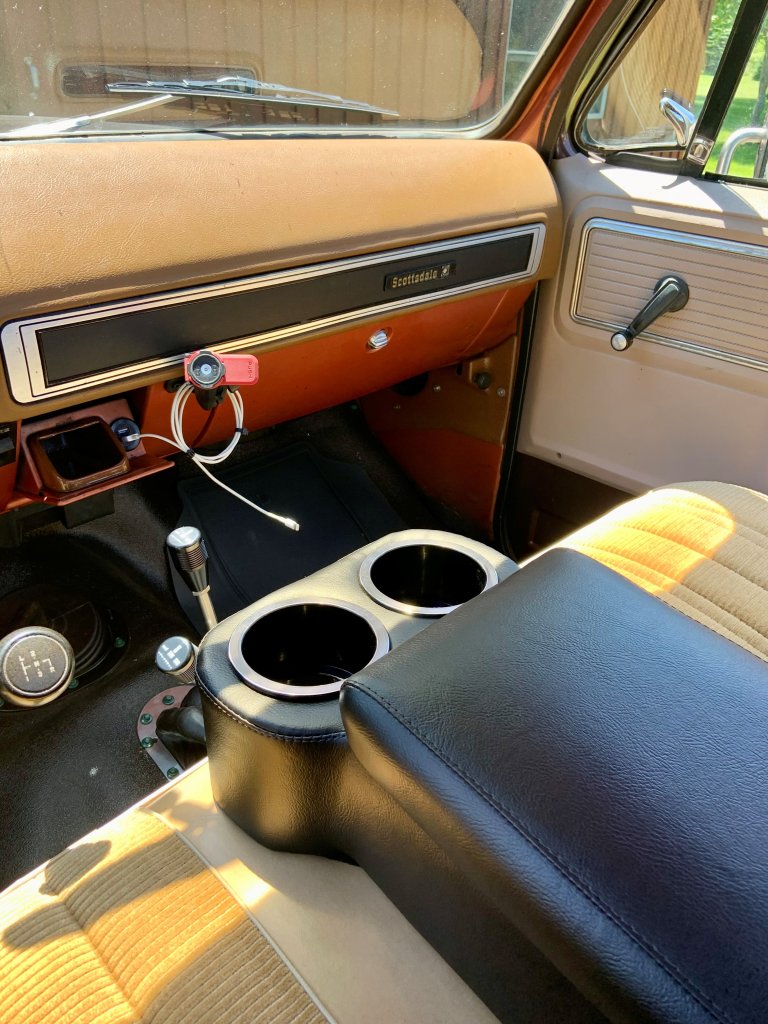

Quad Lock phone mount (I use them in my car and motorcycle too), swapped out the old cigarette lighter socket for a dual USB socket, and a very nice center console showed up yesterday.

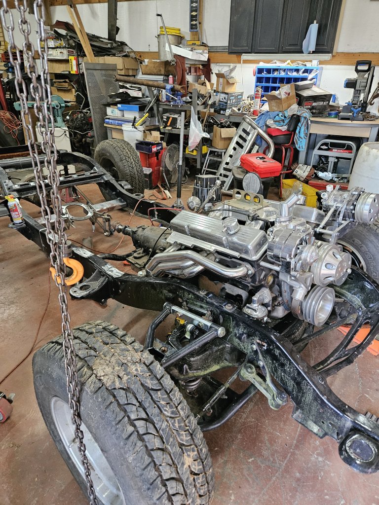

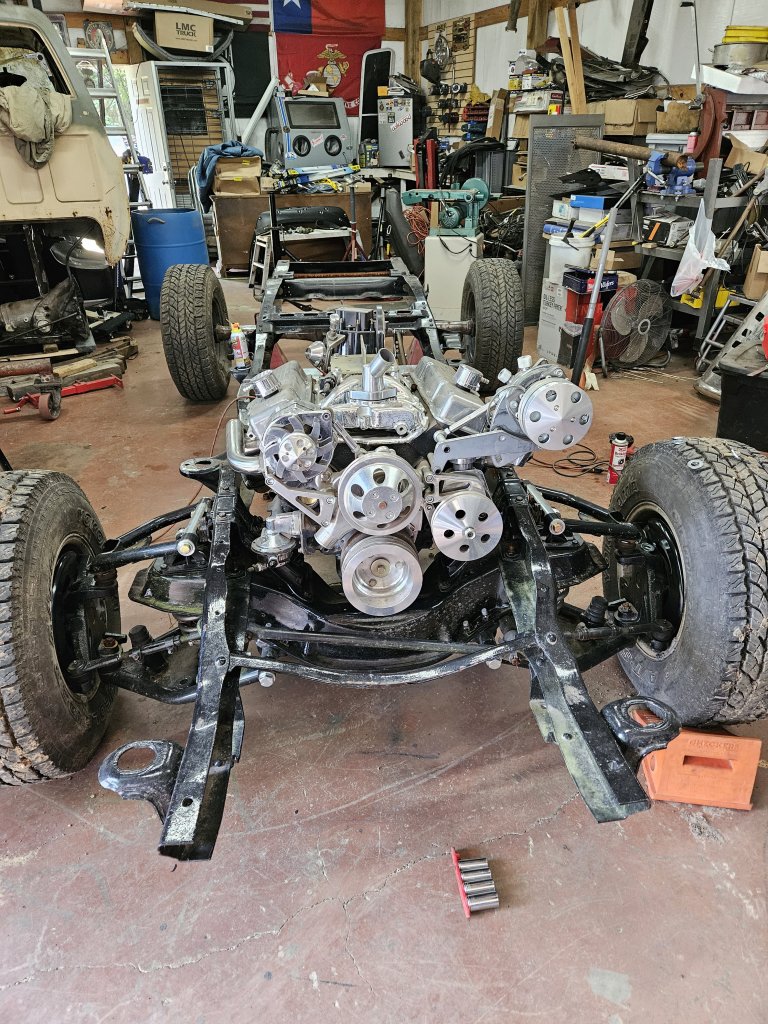

Put the motor and transmission in for mock up.
