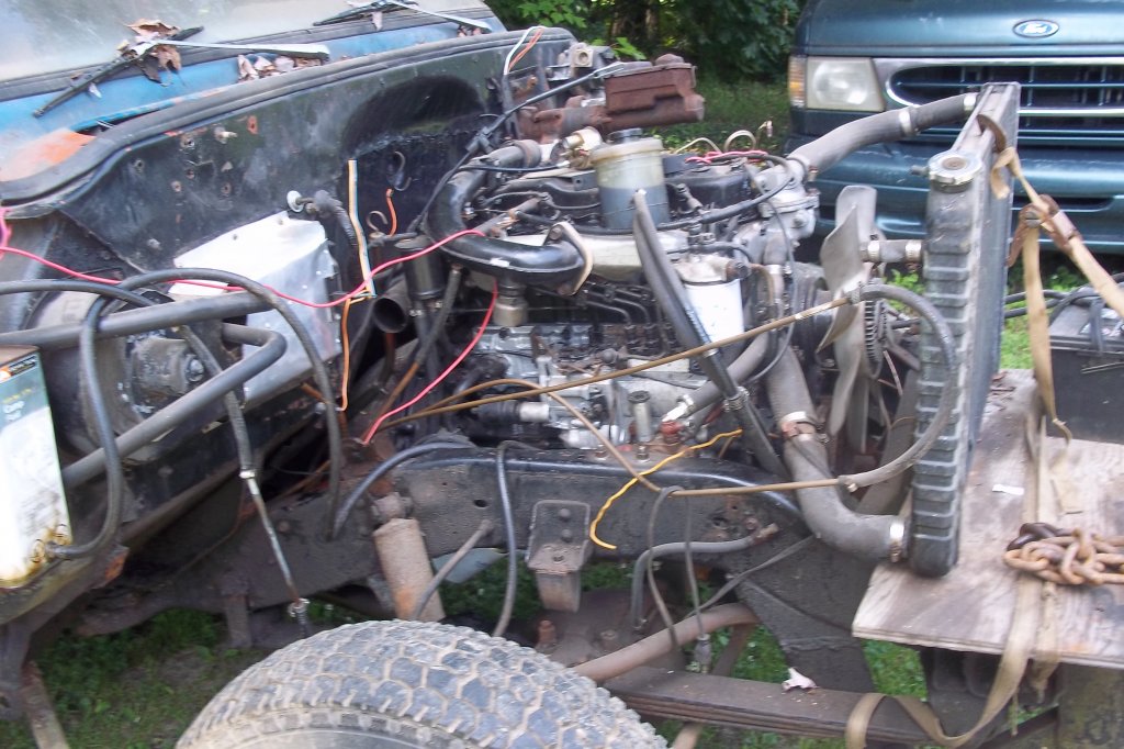

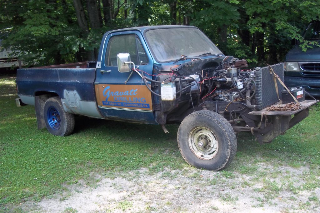

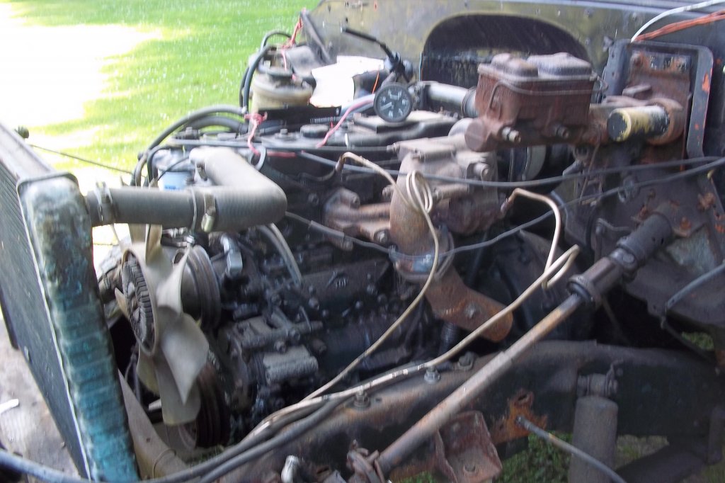

Aired up both ft tires, One held air. Cleaned, Made up Batt, cables,,, Put fuel in temp fuel tank. Hope to put fire in 4 holes this Sat

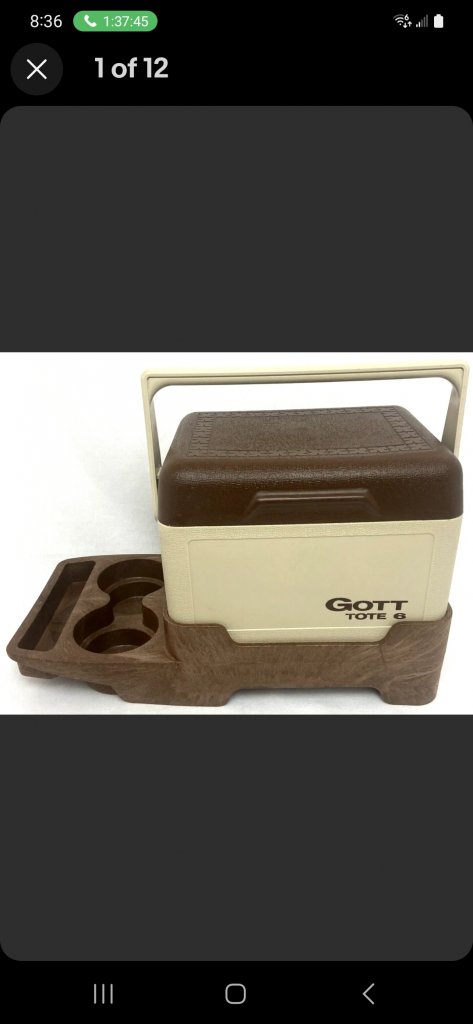

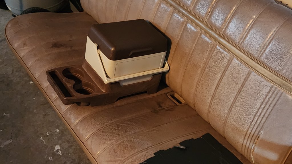

Not so much to the square, as for the square. Picked up a vintage Gott Tote 6 road sody and cup holder combo. Holds a sixer or four and two sandos if you prefer. Pull the cooler and you have a massive tray. Almost went with the Igloo Little Koolrest, but this seemed more stable and utilitarian. Bonus it matches my paint scheme lol
