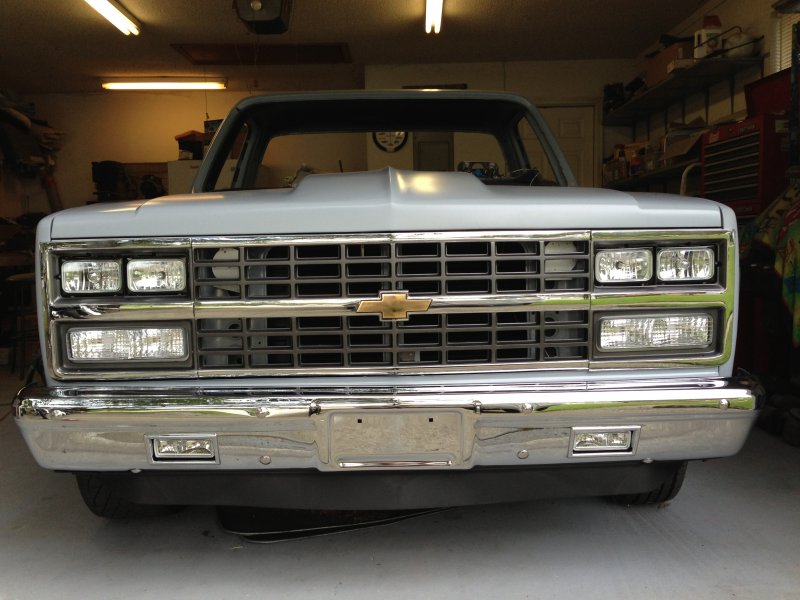

Got my new grill, lights and bumper installed.

That's pretty slick looking. How do those bumper driving lights work? I've always liked driving lights on my newer trucks. I can sure see alot better using those.

Haven't tried them. The only wiring in the truck is enough to run the engine. I'm too lazy to push it in/out of the garage when I need to put something else in there. The bumper came with a wiring harness with a toggle switch to run the lights.

Whoo sexy!!! Gotta love the shinies!

That looks mighty nice. I too like them driving lights. A full report on those, wiring them in and, the final report of functionality.
Going to be awhile, tuck is going to paint before wiring will be done.

The hood was a real pain in the ass to fit. I had to move the mounting holes for the rear hinges by drilling new ones then welding up the originals. Then had to take a 2x4 and a hammer to the edges of the hood to get the contour to match the fenders. Still need to fix the right side of the bumper. The outer bumper bracket on that side has the bumper pushed up too high. I see some cutting and welding on that bracket. I just love fitting aftermarket sheetmetal.
