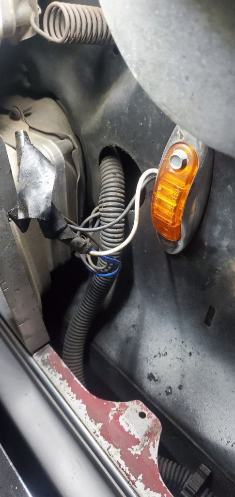

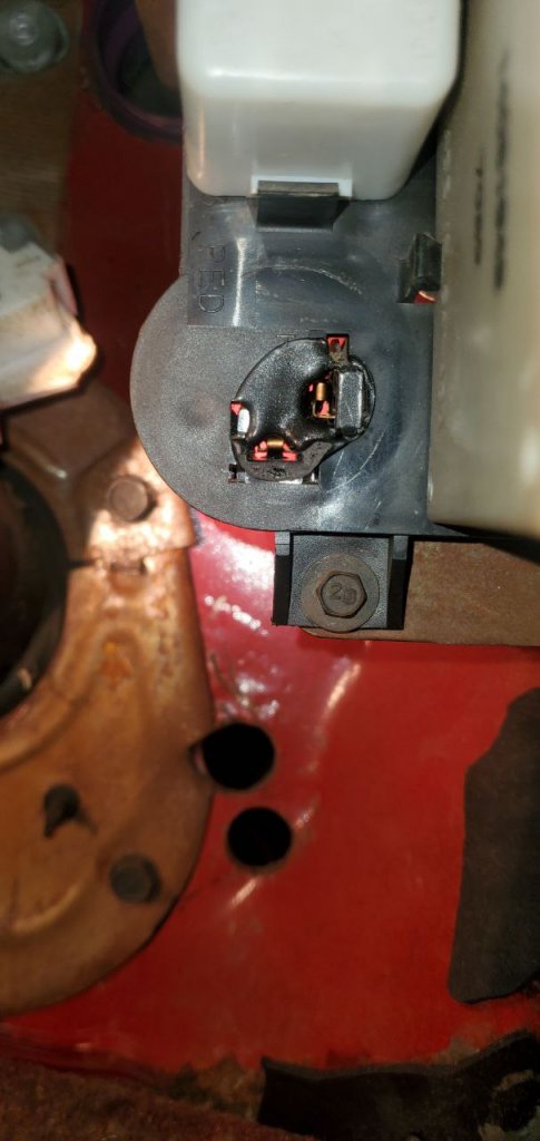

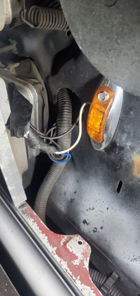

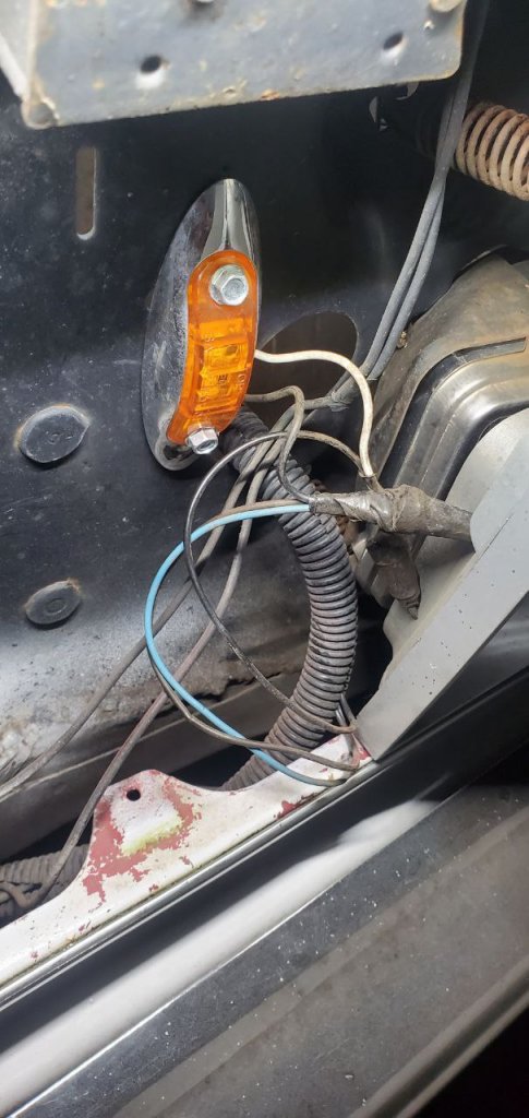

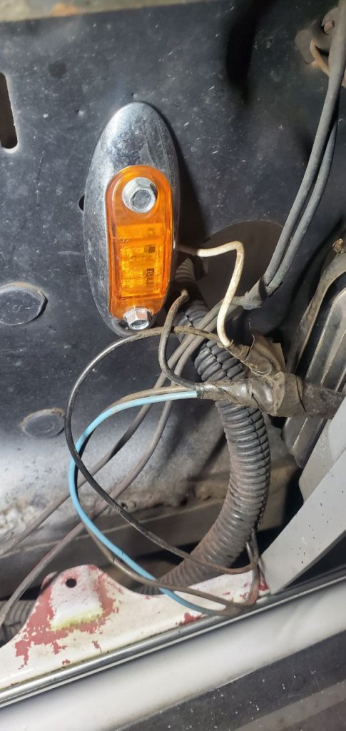

Alright I did a bit more diagnosis before I called it a night and I have a few pictures of the lights and hazard flasher can plug attached. If I flip the dual tank switch to any other setting the fuel pump won't engage but it will still blow the turn signal fuse (I think I forgot to mention leaving the right turn signal on will blow the fuse after a bit of time). Also, I found out that the left turn signal doesn't work at all if the headlights are on and that if the headlights are off the left turn signal blinks/flashes the dash lights. I will also add that the fuel pump will always go on no matter the headlights if I turn on the right directional. I have not checked the bus bar I will check that tomorrow. Also, there is no wiring for a trailer on the truck.
