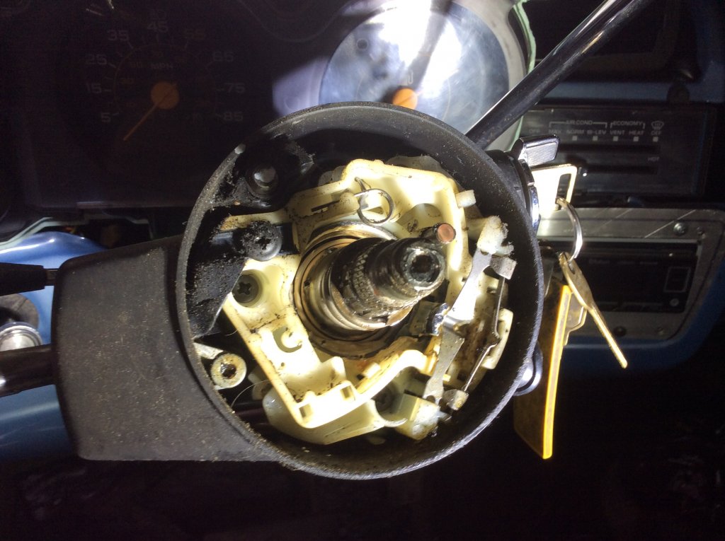

a little update, got the steering wheel and the locking plate off, found one of the springs on the old switch laying on the column housing, broken. seems to be a lot of grease, normal-not normal??? Gonna take some pictures before I go any further so I can remember how it goes back together. The horn wasn't working so I will look into that as well while the truck is in surgery!!LOL

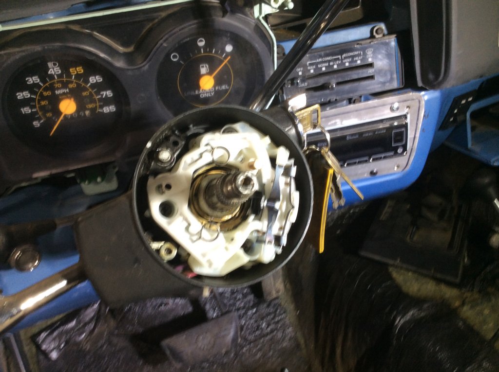

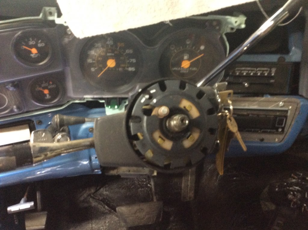

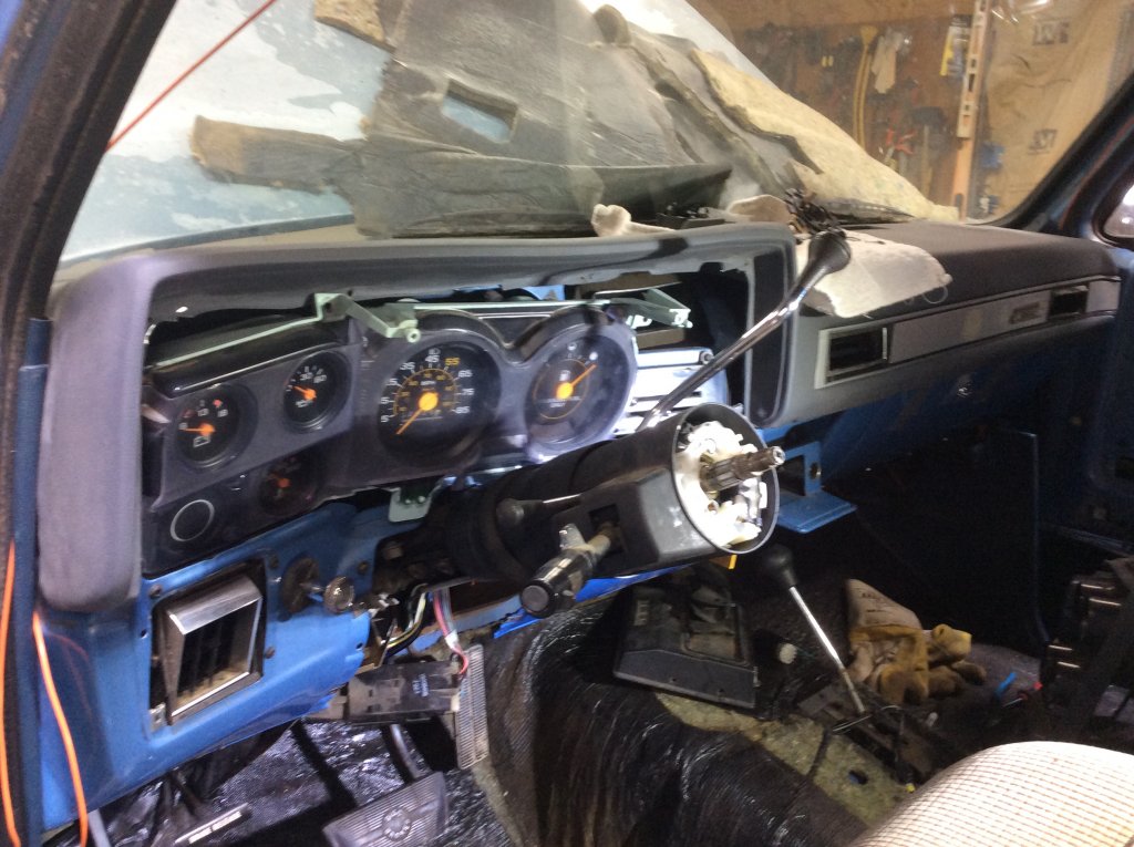

Here is where I am at this morning. Seems to be a lot of grease on the turn signal switch.

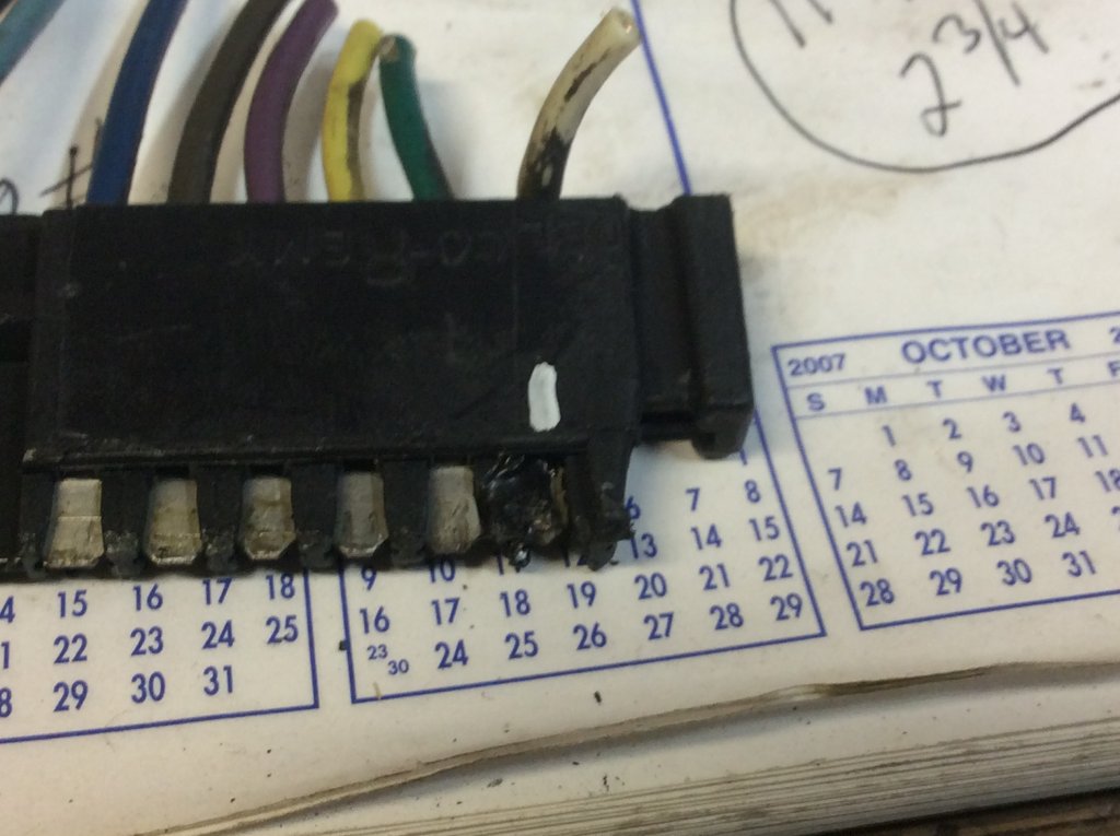

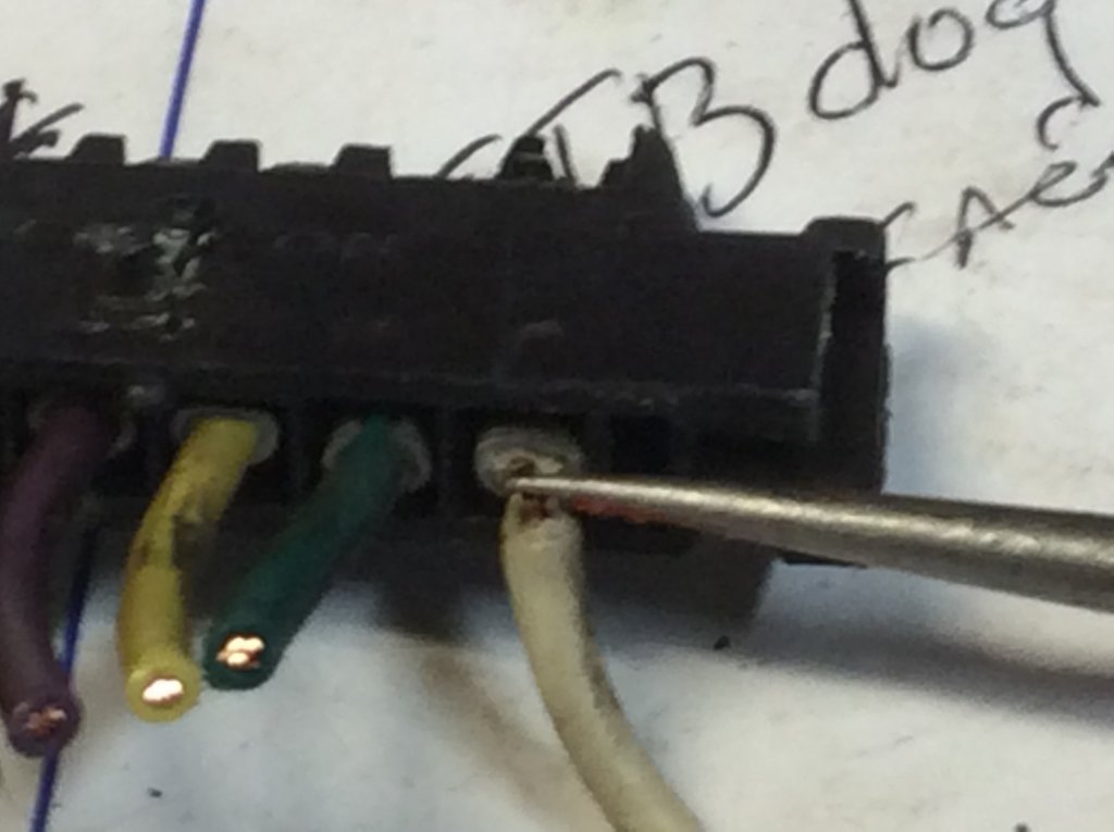

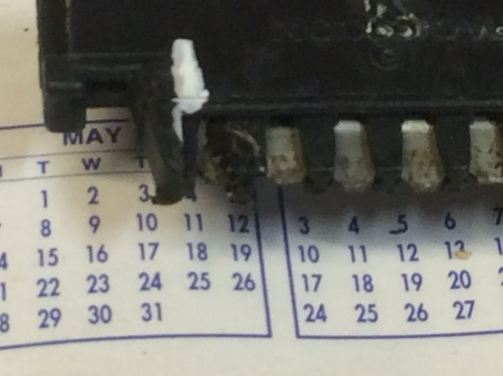

Another update,found the problem,one wire on tur signal switch burnt. I put white paint to make it more visible
