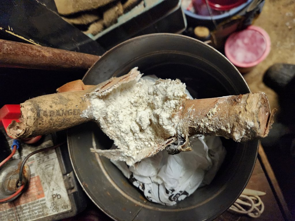

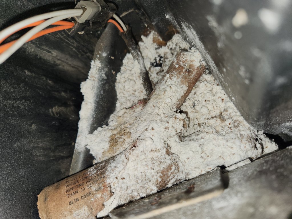

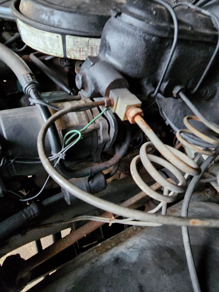

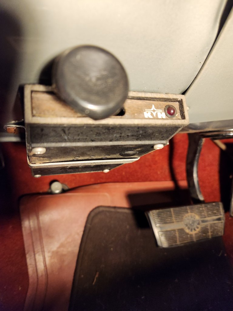

I intended to send pictures of the trailer brakes setup; but now it may be a moot point since I have broken something in the rear "pumpkin". I have yet to open the differential, (I am afraid of what I will find). I have included the pictures of the brake controller and how it connects to the master cylinder. I have also included pictures of something that I found in the back of my truck cab behind the drivers seat. Does anyone know what this is,and what would be a good caption.

These look like old road flares. Probably got wet. Still may be flammable, be careful.
